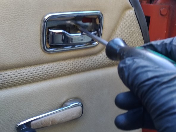

Pry out the black plastic cup behind the door lever, using your pick or flat-head screwdriver
Then remove the single phillips #2 bolt, taking care to retain the lockwasher

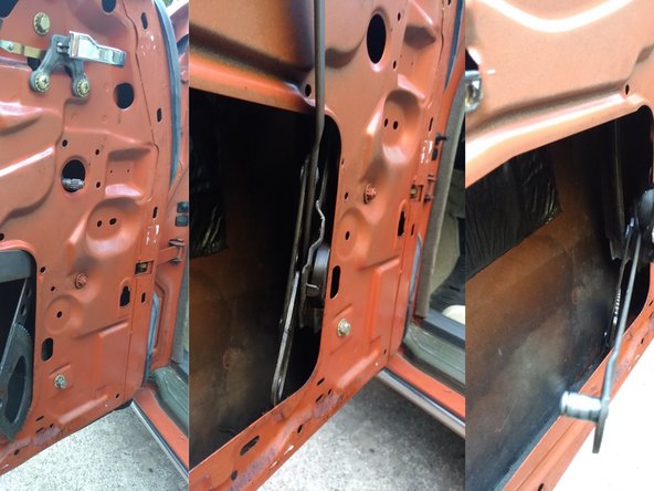

There are four bolts (circled in blue) holding the regulator to the door, they are all 10mm head bolts, but the top two are longer
I used a 10mm deep socket on a 1/4 inch ratchet, but any 10mm wrench, spanner, or socket should work
in the second picture you can see the gear-quadrant of my old regulator hanging down, it's supposed to be up engaged in the winder gear teeth
It was at this point that I realised I could not get the old regulator past the window vertical track...
Notice I'm using a short prybar to prop up the window now (since otherwise it drops down) you could use a piece of wood or some other tool as well
Since you can't get the regulator out past the window track, it has to be detached temporarily
It's held on by two 10mm bolts, which have fancy dimpled flat washers, and lock washers, I've circled them in green in the picture
Remove those two bolts, which should give you enough movement to push that window track forward off the window a bit, then into the door a bit deeper
At this point it should be possible to pull out the window regulator, angling it as you go to avoid jamming on things
