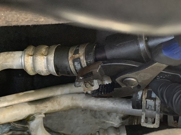

    3. 2005 Chrysler Town & Country 3.8L Heater Control Valve Replacement: adım 3, 3 resimden 1. 2005 Chrysler Town & Country 3.8L Heater Control Valve Replacement: adım 3, 3 resimden 2. 2005 Chrysler Town & Country 3.8L Heater Control Valve Replacement: adım 3, 3 resimden 3.
      • Use pliers to squeeze the clamp tabs on the right side of the valve.
      • While squeezing the clamp tabs, pull the hose to the right to disconnect it from the valve.

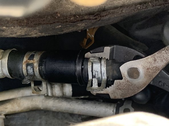

    4. 2005 Chrysler Town & Country 3.8L Heater Control Valve Replacement: adım 4, 2 resimden 1. 2005 Chrysler Town & Country 3.8L Heater Control Valve Replacement: adım 4, 2 resimden 2.
      • Take note of the original orientation of the valve before removal.
      • Use pliers to squeeze the clamp tabs on the left side of the valve.
      • While squeezing the left valve clamp tabs, disconnect the left side of the valve from the hose.
