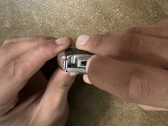

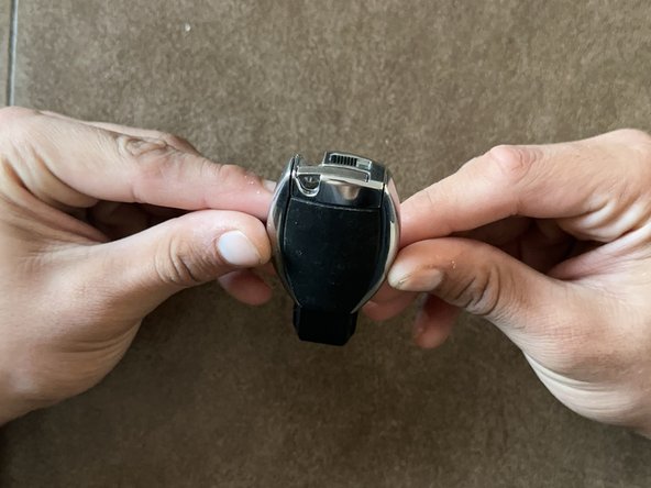

    • The release switch is at the bottom of the key under the unlock button and the trunk button.
    • Slide the release switch to the side.
    • While sliding the release switch, pull the key out.

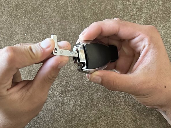

  2. 2006-2015 Mercedes Key Fob Battery Replacement: adım 2, 2 resimden 1. 2006-2015 Mercedes Key Fob Battery Replacement: adım 2, 2 resimden 2.
    • Insert the key in the inside slit to release the back cover.
    • Remove the back cover.

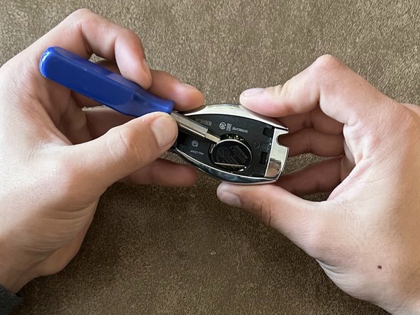

  3. 2006-2015 Mercedes Key Fob Battery Replacement: adım 3, 3 resimden 1. 2006-2015 Mercedes Key Fob Battery Replacement: adım 3, 3 resimden 2. 2006-2015 Mercedes Key Fob Battery Replacement: adım 3, 3 resimden 3.
    • Insert the pointed end of a spudger in the gap between the battery and the key.
    • Push up after inserting the screwdriver to pry the battery out.

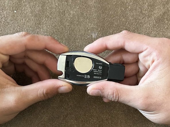

  4. 2006-2015 Mercedes Key Fob Battery Replacement: adım 4, 2 resimden 1. 2006-2015 Mercedes Key Fob Battery Replacement: adım 4, 2 resimden 2.
    • Slide the new battery in at the edge first. (It should fall into place.)
