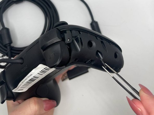

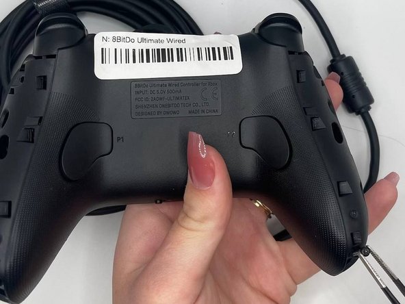

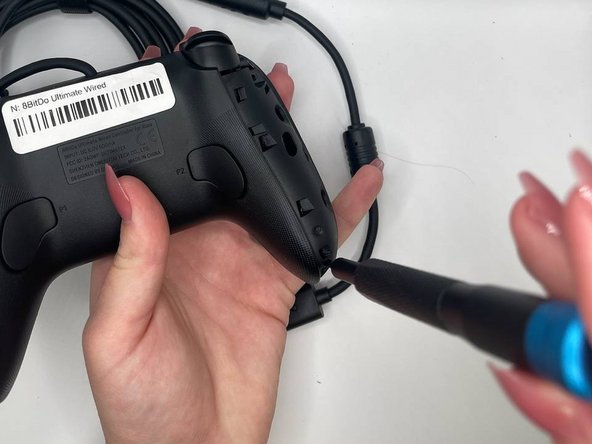

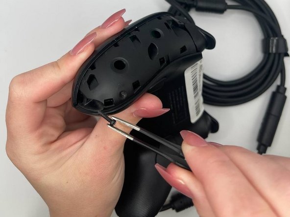

    • Use the TR6 Torx Security screwdriver to remove the top left 10.44 mm torx screw on the backside.
    • Use tweezers to remove the screws (optional).

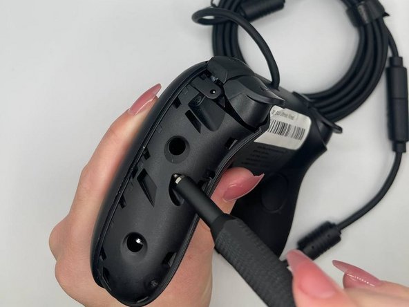

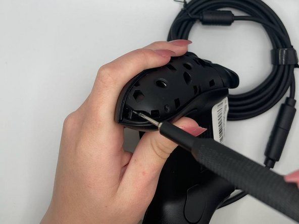

    • Use the TR6 Torx Security screwdriver to remove the middle left 10.44 mm Torx screw on the backside.
  5. 8BitDo Ultimate Wired Motherboard Replacement: adım 5, 3 resimden 1. 8BitDo Ultimate Wired Motherboard Replacement: adım 5, 3 resimden 2. 8BitDo Ultimate Wired Motherboard Replacement: adım 5, 3 resimden 3.

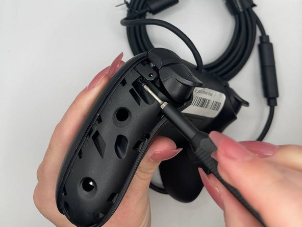

    • Use the TR6 Torx Security screwdriver to remove the bottom left 10.44 mm Torx screw on the backside.
  6. 8BitDo Ultimate Wired Motherboard Replacement: adım 6, 3 resimden 1. 8BitDo Ultimate Wired Motherboard Replacement: adım 6, 3 resimden 2. 8BitDo Ultimate Wired Motherboard Replacement: adım 6, 3 resimden 3.

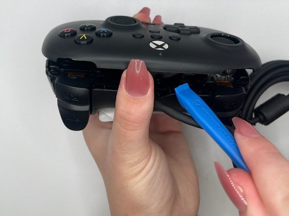

    • Orient the controller such that the back of the controller is facing you.

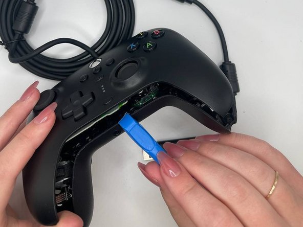

    • Insert an opening tool into the small opening between the front and back panels, and gently pry the back panel away to open the bottom clamps of the top panel of the controller.

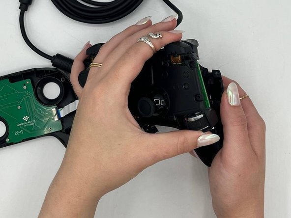

  10. 8BitDo Ultimate Wired Motherboard Replacement: adım 10, 2 resimden 1. 8BitDo Ultimate Wired Motherboard Replacement: adım 10, 2 resimden 2.
    • Insert an opening tool into the small opening between the front and back panel (top view) and pry away to remove the top half.
    • A ribbon cable connects the front and back portions of the controller.

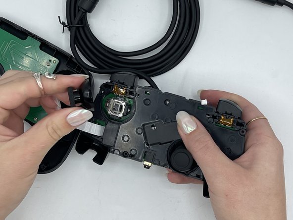

    • Use your fingers to remove the joystick cover on the left hand side with adequate force.
  17. 8BitDo Ultimate Wired Motherboard Replacement: adım 17, 3 resimden 1. 8BitDo Ultimate Wired Motherboard Replacement: adım 17, 3 resimden 2. 8BitDo Ultimate Wired Motherboard Replacement: adım 17, 3 resimden 3.
    • Use your fingers to remove the joystick cover on the right hand side with adequate force.

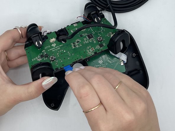

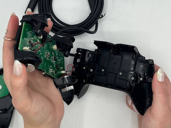

    • Use an opening tool to pry the motherboard apart from the structure of the controller

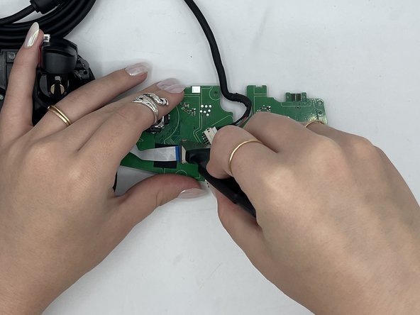

  19. 8BitDo Ultimate Wired Motherboard Replacement: adım 19, 3 resimden 1. 8BitDo Ultimate Wired Motherboard Replacement: adım 19, 3 resimden 2. 8BitDo Ultimate Wired Motherboard Replacement: adım 19, 3 resimden 3.

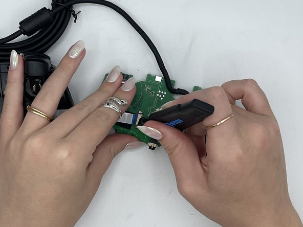

    • Use a Jimmy to open the small metal bracket (right) on the front side of the motherboard.

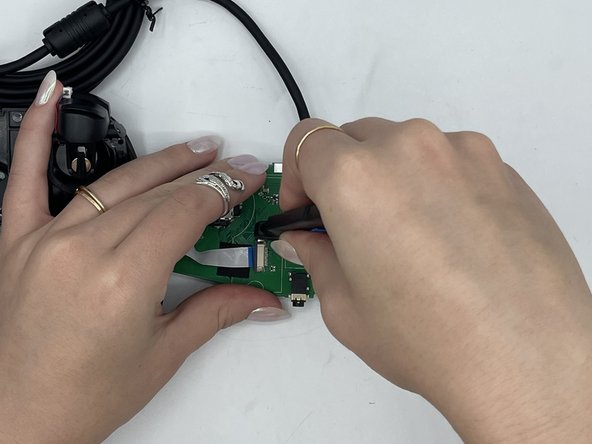

  20. 8BitDo Ultimate Wired Motherboard Replacement: adım 20, 3 resimden 1. 8BitDo Ultimate Wired Motherboard Replacement: adım 20, 3 resimden 2. 8BitDo Ultimate Wired Motherboard Replacement: adım 20, 3 resimden 3.
    • Use a Jimmy to open the small metal bracket (left) on the front side of the motherboard.
  21. 8BitDo Ultimate Wired Motherboard Replacement: adım 21, 3 resimden 1. 8BitDo Ultimate Wired Motherboard Replacement: adım 21, 3 resimden 2. 8BitDo Ultimate Wired Motherboard Replacement: adım 21, 3 resimden 3.
    • Use tweezers to remove the white strip from the black bracket.
  22. 8BitDo Ultimate Wired Motherboard Replacement: adım 22, 3 resimden 1. 8BitDo Ultimate Wired Motherboard Replacement: adım 22, 3 resimden 2. 8BitDo Ultimate Wired Motherboard Replacement: adım 22, 3 resimden 3.

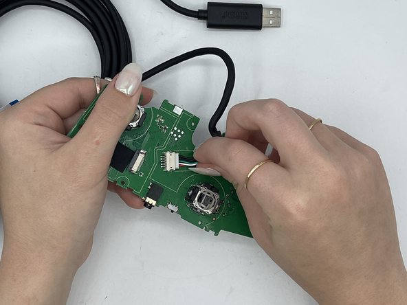

    • Use your fingers to gently remove the power cord.
