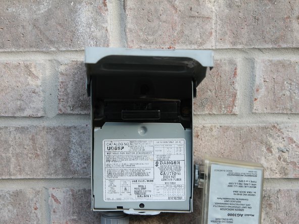

    • Go to the condenser unit outside the house and locate the breaker panel connected to the unit.
  2. AC Capacitor for A/C Condenser Unit Replacement: adım 2, 3 resimden 1. AC Capacitor for A/C Condenser Unit Replacement: adım 2, 3 resimden 2. AC Capacitor for A/C Condenser Unit Replacement: adım 2, 3 resimden 3.
    • Open the breaker panel and pull out the fuse inside.
    • Turn off the power by removing the fuse or flipping the switch on the disconnect box before continuing on with the guide. Leaving the power on during repair could result in serious injury or death.

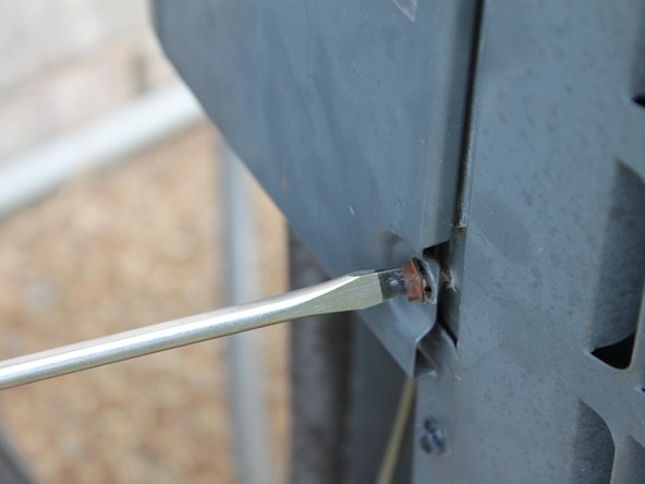

    • Locate the metal sheet cover hiding the capacitor and unscrew the panel from the condenser unit using the screwdriver or the drill bit
    • Usually, there are two screws on the bottom of the electrical panel that are the screws holding the panel to the condenser unit.
    • Screw size/type is dependent on the model of the condenser unit.

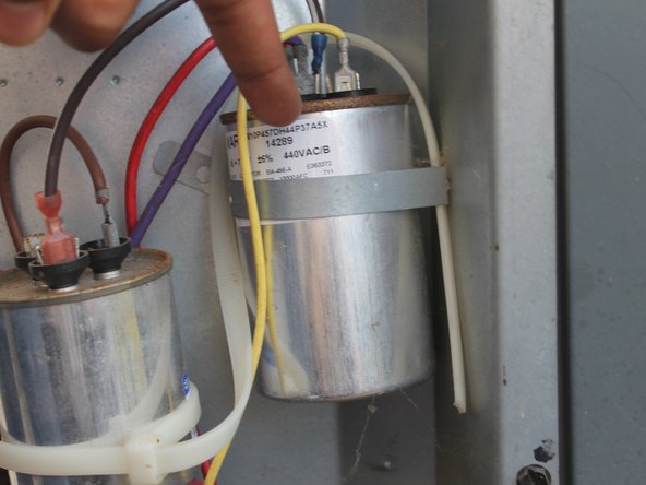

    • Some condenser units have 1 run capacitor, some have 2. Steps are the same for each but you have to buy replacements for each capacitor.
    • Do not touch the metal part of the wires. They are still connected to a charged capacitor and can still shock you. Pull wires from the insulated parts.
    • Take pictures or remember where each colored wire is connected, and pull each wire straight up to disconnect from capacitor.

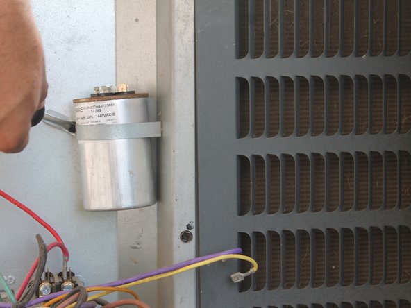

    • Locate the bracket holding the capacitor to the condenser unit and unscrew it.

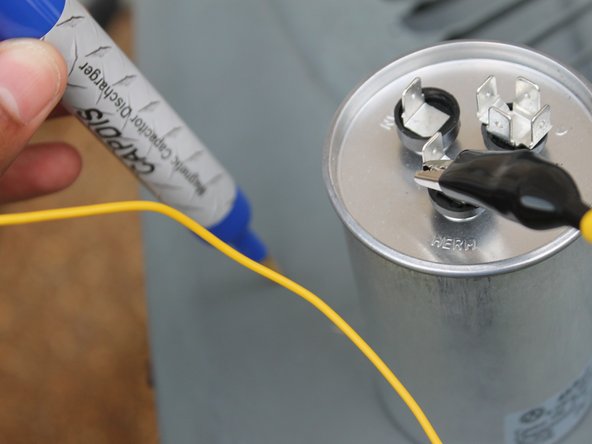

    • Using the capacitor discharge pen, connect wire lead to the common terminal of the capacitor, the 'C' side of the capacitor. Then touch the brass tip of the capactior to any nearby ground, frame, or chassis.
    • Repeat these steps with the herm side and then the fan side of the capacitor to a nearby ground, frame, or chassis.
    • After discharging the capacitor, you can safely dispose of the capacitor responsibly.
    • Harzardous situation which can result in injury or death. The discharge process should only be used with a certified capacitor discharge tool.
    • Most state or local government websites will have information on how to dispose of electronics safetly.
