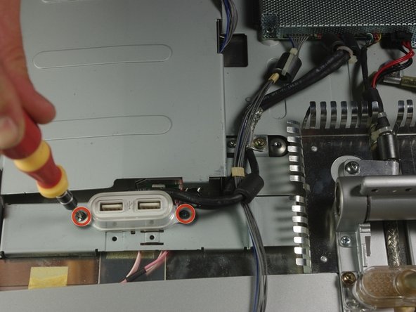

    • Before starting, make sure the display is UNPLUGGED. Failure to do so can result in shock and serious injury.
    • Flip the Cinema Display so it is on its face and the feet are pointed away from you.
    • Using the PH 2 screwdriver, unscrew the three feet screws (9.52 x 4.43 mm).
    • Remove the back foot from the hinge mount by gently pulling it upwards.
  2. Apple Cinema Display M8149 USB Port Replacement: adım 2, 3 resimden 1. Apple Cinema Display M8149 USB Port Replacement: adım 2, 3 resimden 2. Apple Cinema Display M8149 USB Port Replacement: adım 2, 3 resimden 3.
    • Remove the back plate screws (5.25 x 4.43 mm) using the PH 2 screw driver.
    • Once the screws are removed, lift the back plate off of the display.
    • Completely remove the back plate and set it aside.
  3. Apple Cinema Display M8149 USB Port Replacement: adım 3, 1 resimden 1.
    • Unscrew the USB cable routing screw (8 x 2.72mm) using the PH 2 screwdriver.
  4. Apple Cinema Display M8149 USB Port Replacement: adım 4, 1 resimden 1.
    • Unplug the USB cable connector from the screen box.
  5. Apple Cinema Display M8149 USB Port Replacement: adım 5, 2 resimden 1. Apple Cinema Display M8149 USB Port Replacement: adım 5, 2 resimden 2.
    • Using the PH 2 screwdriver, unscrew the two screws (4.85 x 2.94mm) on the USB ports.
