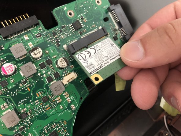

  11. Asus F555LA-AB31 Network Card Replacement, Network Card: adım 11, 1 resimden 1.
    • Disconnect the two wires connected to the network card.
  12. Asus F555LA-AB31 Network Card Replacement: adım 12, 3 resimden 1. Asus F555LA-AB31 Network Card Replacement: adım 12, 3 resimden 2. Asus F555LA-AB31 Network Card Replacement: adım 12, 3 resimden 3.
    • Remove the seven Phillips #0 screws holding the motherboard down.
    • Lift the motherboard upwards, folding it towards the laptop chassis.
    • Unscrew the Phillips #0 screw holding down the network card, and slide it out.
