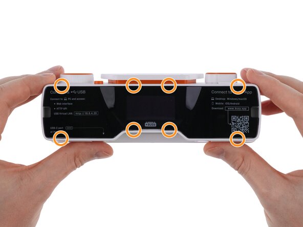

    1. BUSY Bar Disassembly, Remove the back cover: adım 1, 3 resimden 1. BUSY Bar Disassembly, Remove the back cover: adım 1, 3 resimden 2. BUSY Bar Disassembly, Remove the back cover: adım 1, 3 resimden 3.
      • The back cover is held in place by 8 clips.
      • Use a plastic card to release one of the clips near the center at the bottom of the back cover.
      • Gently release the remaining clips until the back cover comes off completely.

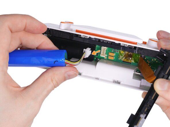

    4. BUSY Bar Disassembly, Remove the battery: adım 4, 3 resimden 1. BUSY Bar Disassembly, Remove the battery: adım 4, 3 resimden 2. BUSY Bar Disassembly, Remove the battery: adım 4, 3 resimden 3.
      • Gently move the battery to the left so you can access the connector.
      • Use tweezers or your fingertip to press the connector latch.
      • Pull the battery connector to disconnect it from the PCB.
