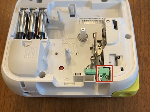

  4. Brother PT-210 Cutter Blade Replacement, Remove Cutter Blade: adım 4, 3 resimden 1. Brother PT-210 Cutter Blade Replacement, Remove Cutter Blade: adım 4, 3 resimden 2. Brother PT-210 Cutter Blade Replacement, Remove Cutter Blade: adım 4, 3 resimden 3.
    Bu adımda kullanılan alet:
    Spudger
    $3.99
    • This is the cutter blade.
    • WARNING: The cutter blade is sharp
    • Pull this up and out with your fingers or a spudger.
Sonuç
To reassemble your device, follow these instructions in reverse order. For a new cutter blade if you need one, just look on Amazon.
