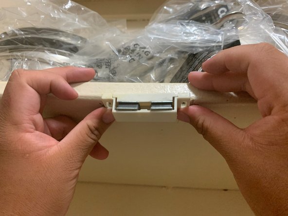

  3. Cabinet Magnetic Catch Replacement: adım 3, 3 resimden 1. Cabinet Magnetic Catch Replacement: adım 3, 3 resimden 2. Cabinet Magnetic Catch Replacement: adım 3, 3 resimden 3.
    • Place the new magnetic catch on the center of the shelf cabinet.
    • Ensure it is adjusted carefully by moving its width halfway out of the cabinet and aligned on each side.

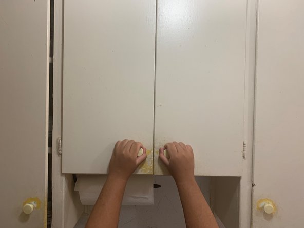

  8. Cabinet Magnetic Catch Replacement: adım 8, 3 resimden 1. Cabinet Magnetic Catch Replacement: adım 8, 3 resimden 2. Cabinet Magnetic Catch Replacement: adım 8, 3 resimden 3.
    • Test the cabinet magnetic catch by closing it.
    • You are finished when the cabinet stays closed after letting your hands go.
