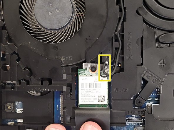

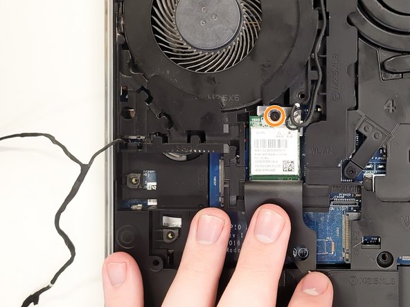

  6. Dell Alienware 15 R3 Wi-Fi Card Replacement, Wi-Fi Card: adım 6, 3 resimden 1. Dell Alienware 15 R3 Wi-Fi Card Replacement, Wi-Fi Card: adım 6, 3 resimden 2. Dell Alienware 15 R3 Wi-Fi Card Replacement, Wi-Fi Card: adım 6, 3 resimden 3.
    • Open the flap to reveal the Wi-Fi card.
    • Use the Phillips #00 screwdriver to remove the screw securing the Wi-Fi card.
    • Use a spudger to detach the coaxial cables from the Wi-Fi card.
    • Be careful when detaching these cable connectors from the Wi-Fi card. The base of the connectors are prone to break off.
