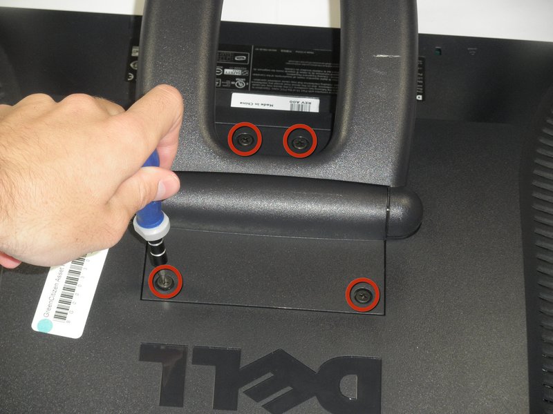

      • Lay the monitor screen-down so the back screws are exposed.
      • Remove the four 11.9 mm Phillips #2 screws securing the stand to the back of the monitor.

      • Gently lift and pull away the stand at a slight angle away from the monitor.
