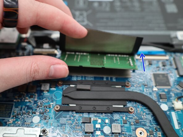

  4. Dell Latitude 3310 RAM Replacement, RAM: adım 4, 2 resimden 1. Dell Latitude 3310 RAM Replacement, RAM: adım 4, 2 resimden 2.
    • Lift the plastic cover up to expose the memory chipset.
    • Carefully pull the clips away from the chip to disengage them.
