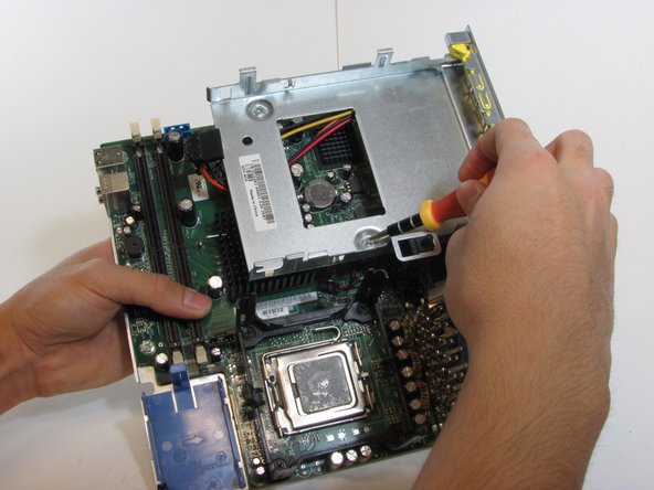

  29. Dell Optiplex SX280 Motherboard Replacement: adım 29, 3 resimden 1. Dell Optiplex SX280 Motherboard Replacement: adım 29, 3 resimden 2. Dell Optiplex SX280 Motherboard Replacement: adım 29, 3 resimden 3.
    • Remove the four screws located on heat sink stand.
    • The heat sink stand can now be lifted from the motherboard.

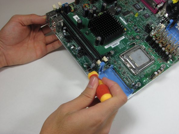

  30. Dell Optiplex SX280 Motherboard Replacement: adım 30, 2 resimden 1. Dell Optiplex SX280 Motherboard Replacement: adım 30, 2 resimden 2.
    • Remove the four screws holding the motherboard to the rear computer panel.
