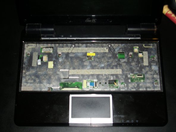

  1. Disassembling Asus Eee PC 1000HE Lower Assembly, Lower Assembly: adım 1, 1 resimden 1.
    • Turn off the power and remove the battery before working on your Eee PC
    • Start by removing the keyboard
    • There are four latches on the top of the keyboard, use a paper clip or other object to disengage the latches
    • You may have to pull the keyboard up enough with the object - there is no spring mechanism to pop the keyboard out. One trick is after lifting it enough, to slide it (not too much) upward to remove the bottom side.
    • The keyboard assembly has also two plastic retention points on the sides, and some thermal tape sticking the keyboard down.
    • Caution: the keyboard has a ribbon connector underneath it which must be carefully unplugged before fully removing the keyboard.
  2. Disassembling Asus Eee PC 1000HE Lower Assembly: adım 2, 2 resimden 1. Disassembling Asus Eee PC 1000HE Lower Assembly: adım 2, 2 resimden 2.
    • 7 screws hold the front plate to the motherboard, as well as the ones on the rear of the PC.
    • Before taking off the case, you need to disconnect the touchpad and hotkeys cables.
