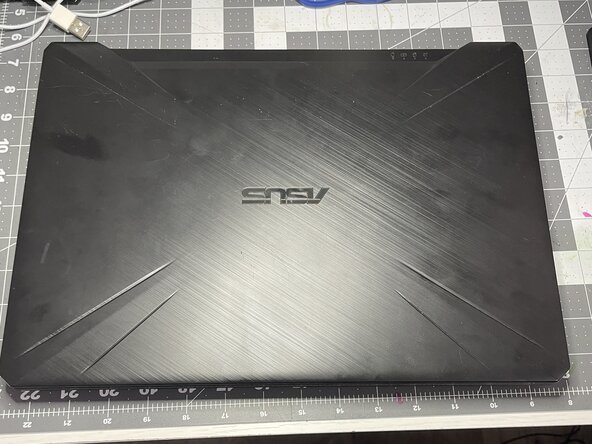

  1. Disassembling Asus FX505G - Inspect Fans - Replace CPU Fan, Turn over laptop and remove screws: adım 1, 2 resimden 1. Disassembling Asus FX505G - Inspect Fans - Replace CPU Fan, Turn over laptop and remove screws: adım 1, 2 resimden 2.
    • Size 1 Phillips Screwdriver
    • M2.5x12mm (long) x 6 ORANGE
    • M2.5x6mm (short) x 5 RED

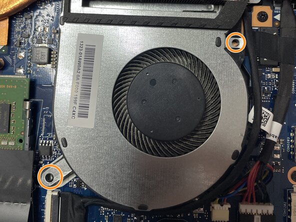

  4. Disassembling Asus FX505G - Inspect Fans - Replace CPU Fan, Disconnect electrical connections, remove fan screws: adım 4, 1 resimden 1.
    • There's a ZIF connecter to disconnect to make it easier to remove the fan
    • Also disconnect the fan's small molex connector
  5. Disassembling Asus FX505G - Inspect Fans - Replace CPU Fan, Remove Fan Screws: adım 5, 1 resimden 1.
    • Remove these two screws
  6. Disassembling Asus FX505G - Inspect Fans - Replace CPU Fan, Remove Fan: adım 6, 1 resimden 1.
    • Gently pull up on adhesive to detach pad from fan plastic arm
    • Gently lift up heat sink to slide fan arm underneath it
    • Remove fan
    • Reverse the instructions to re-install
    • If you have it, you can apply thread lock or Loc-Tite to the screws prior to re-installing.
