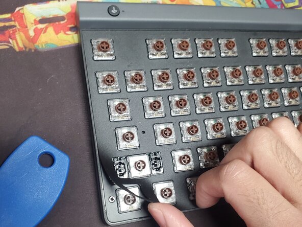

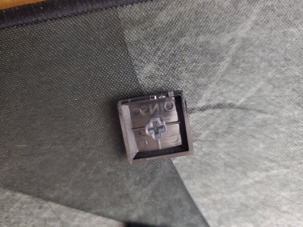

  1. Disassembling Logitech G515 Lightspeed TKL, Remove keycaps: adım 1, 2 resimden 1. Disassembling Logitech G515 Lightspeed TKL, Remove keycaps: adım 1, 2 resimden 2.
    • Remove the keycaps by evenly lifting up each key. Using a spare credit card to lift the south end of the key and my finger from the north end of the key helps remove the keys quickly.
    • The switches are Kailh switches that are soldered to the board.

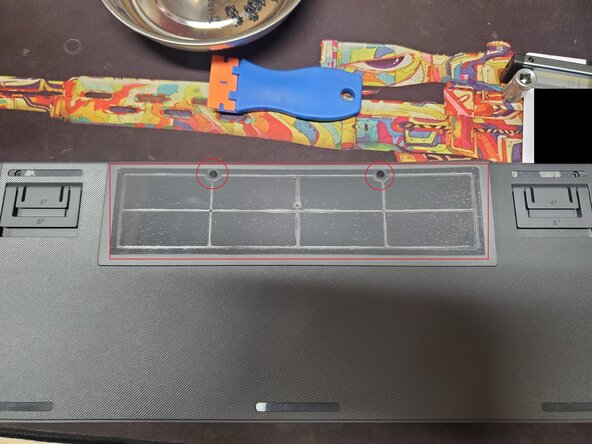

  2. Disassembling Logitech G515 Lightspeed TKL, Remove 2 back screws behind rubber feet: adım 2, 1 resimden 1.
    • Remove the two rubber feet at the top on the backside. Using a heatgun/hairdryer helps soften the adhesive when removing the rubber feet.
    • Removing the bottom 3 rubber feet is not necessary.

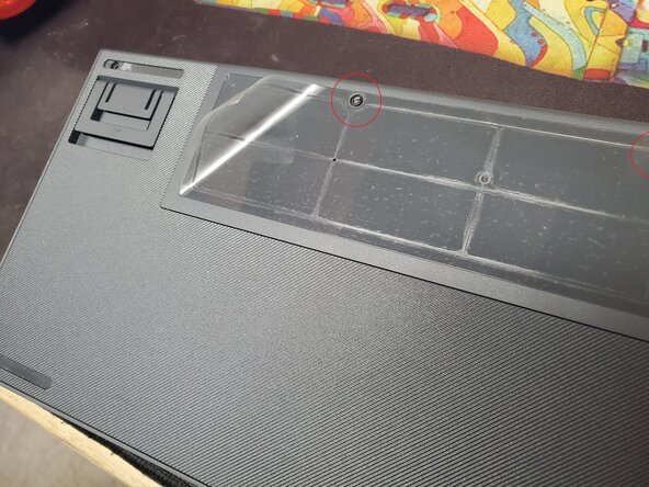

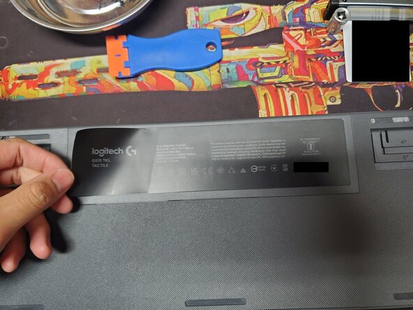

  3. Disassembling Logitech G515 Lightspeed TKL, Remove battery cover plate: adım 3, 3 resimden 1. Disassembling Logitech G515 Lightspeed TKL, Remove battery cover plate: adım 3, 3 resimden 2. Disassembling Logitech G515 Lightspeed TKL, Remove battery cover plate: adım 3, 3 resimden 3.
    • Remove the "battery" cover sticker. Note that mine is a wired G515. Mine came off in 2 pieces (1 is a sticker and another is a thick plastic film). Using a hairdryer/heat gun helps.
    • Remove the 2 screws from the "battery" cover/plate.
    • Then remove the "battery" cover plate.

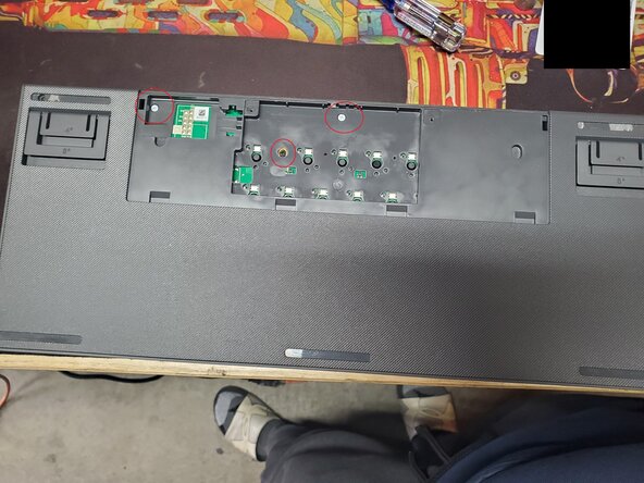

  5. Disassembling Logitech G515 Lightspeed TKL, Remove front keyboard screws: adım 5, 1 resimden 1.
    • Remove the Phillip head screws from the front of the keyboard.

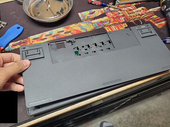

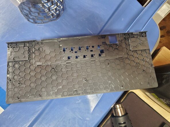

  7. Disassembling Logitech G515 Lightspeed TKL, Removing back plate of keyboard: adım 7, 2 resimden 1. Disassembling Logitech G515 Lightspeed TKL, Removing back plate of keyboard: adım 7, 2 resimden 2.
    • Remove the back plate of the keyboard.
    • This is what the front of the back plate looks like when removed.

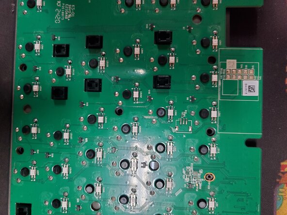

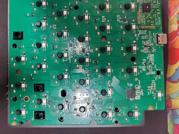

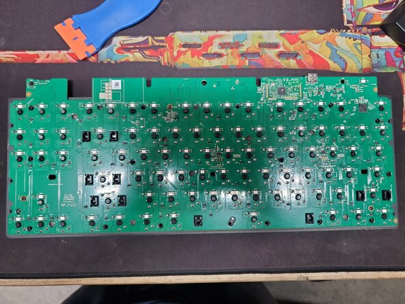

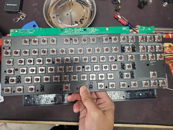

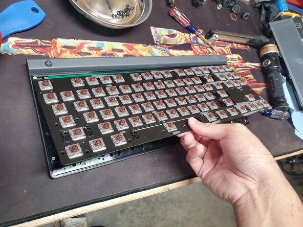

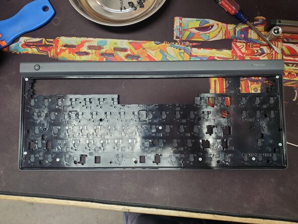

  8. Disassembling Logitech G515 Lightspeed TKL, Remove board: adım 8, 3 resimden 1. Disassembling Logitech G515 Lightspeed TKL, Remove board: adım 8, 3 resimden 2. Disassembling Logitech G515 Lightspeed TKL, Remove board: adım 8, 3 resimden 3.
    • Pull the board out from the keyboard casing/frame.

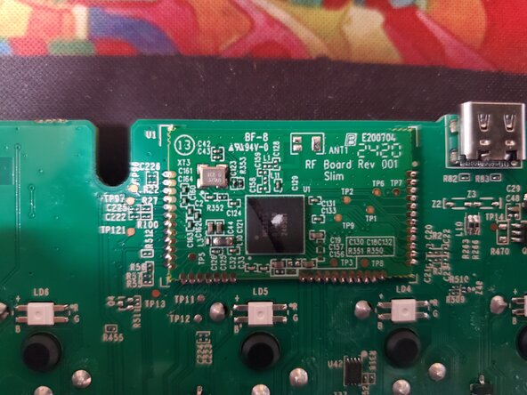

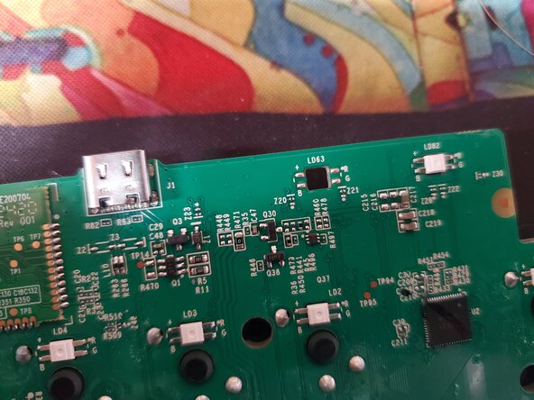

  9. Disassembling Logitech G515 Lightspeed TKL, Extra pictures of board (1): adım 9, 3 resimden 1. Disassembling Logitech G515 Lightspeed TKL, Extra pictures of board (1): adım 9, 3 resimden 2. Disassembling Logitech G515 Lightspeed TKL, Extra pictures of board (1): adım 9, 3 resimden 3.
    • Extra pictures of board (1)

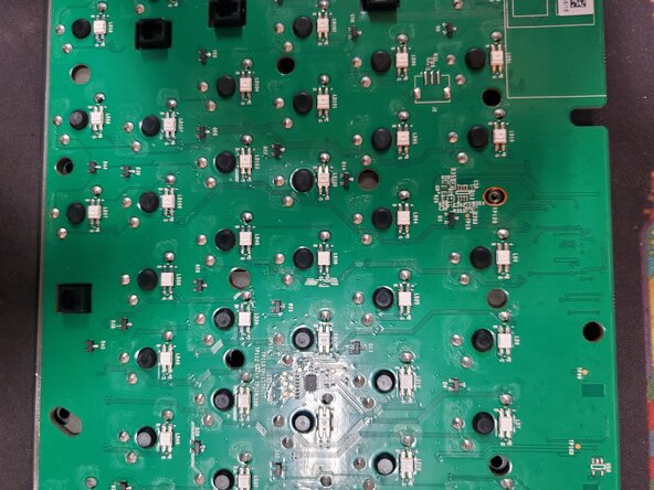

  10. Disassembling Logitech G515 Lightspeed TKL, Extra pictures of board (2): adım 10, 3 resimden 1. Disassembling Logitech G515 Lightspeed TKL, Extra pictures of board (2): adım 10, 3 resimden 2. Disassembling Logitech G515 Lightspeed TKL, Extra pictures of board (2): adım 10, 3 resimden 3.
    • Extra pictures of board (2)

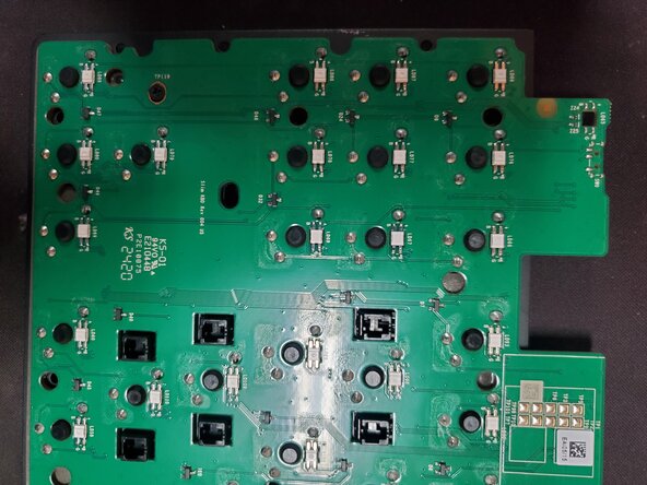

  11. Disassembling Logitech G515 Lightspeed TKL, Extra pictures of board (3): adım 11, 2 resimden 1. Disassembling Logitech G515 Lightspeed TKL, Extra pictures of board (3): adım 11, 2 resimden 2.
    • Extra pictures of board (3)
