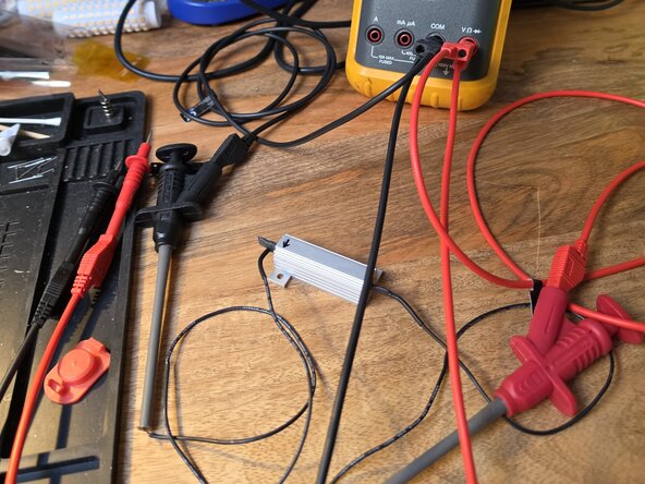

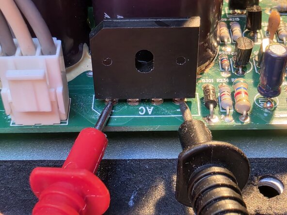

  11. Disassembling REL T5 Main Amplifier: adım 11, 2 resimden 1. Disassembling REL T5 Main Amplifier: adım 11, 2 resimden 2.
    • Discharge the capacitor e.g. using a replacement 1k3 power resistor.
    • Carefully bridge the resistor across the + and - legs of the recifier, but don't touch anything else.

    • Verify that the voltage is near zero. 0.2V or so is fine.
    • The voltage starts at around 100V, so be careful.
