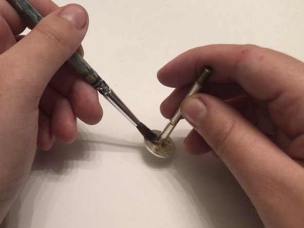

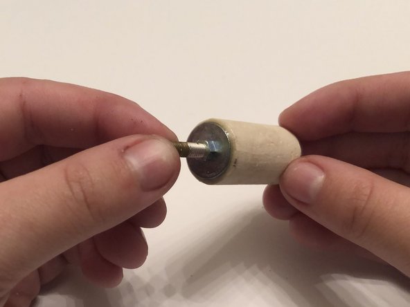

    • Use a small paintbrush to brush on a layer of contact cement onto the bottom of the new cork and the bottom of the screw set up.
    • Let contact cement sit for a few minutes and then slide the cork down onto the screw rod glue side first.

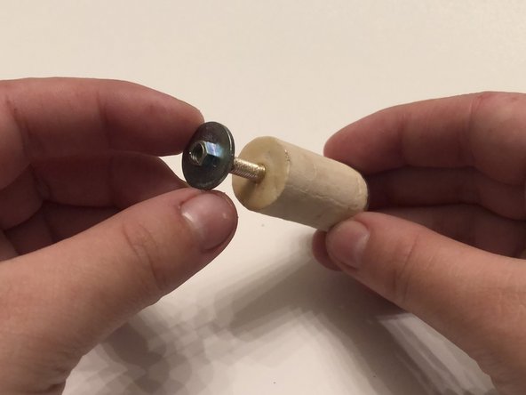

    • Use a small paintbrush to paint a layer of polyurethane glue onto the top of the cork.
    • Do not use contact cement for this step because it will bind on contact and the washer needs to be screwed on.
    • Screw the washer onto the screw rod.
    • Wait for all the glues to dry.

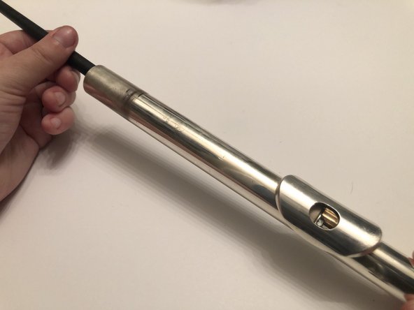

    • Drop the new cork and screw set up screw first into the bottom of the head joint. If the cork is the correct diameter you should be able to see it partially through the embouchure hole.
    • Flute head joints have a tapered diameter that is smaller at the top. This will not work if the cork is put into the top of the head joint.
    • Use the flute tuning rod to push the cork into the head joint until the tuning line at the bottom of the rod is in the middle of the embouchure hole.
    • If the cork is difficult to push down, paraffin wax can be rubbed onto the cork to help lubricate it.

The head joint cork assembly should never be pulled out the top of the head joint! Pulling it with pliers is a terrible idea! Attempting to do so will damage most flute professional head joints (it depends on the size of the cork plate). As a professional flute repair person I have seen a number of head joints with such damage. Because the head joint has a slight taper it must be pushed out the tenon end. Use a 5/8" wooden or plastic rod with a hole drilled a couple inches deep in one end to contain the threaded rod. Go to your repair person and ask for a demonstration.
