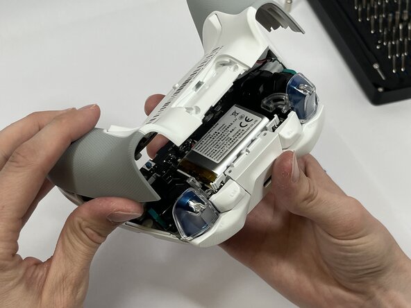

  6. Flydigi Apex 5 Back Paddle Daughterboard Replacement: adım 6, 3 resimden 1. Flydigi Apex 5 Back Paddle Daughterboard Replacement: adım 6, 3 resimden 2. Flydigi Apex 5 Back Paddle Daughterboard Replacement: adım 6, 3 resimden 3.
    • Insert the plastic opening tool between the top and bottom plastic controller molds, then pry until the two pieces separate.
    • Be careful not to fully separate the two pieces of the controller. There is a fragile ribbon cable connecting the two sides that must be carefully disconnected in the next step.
