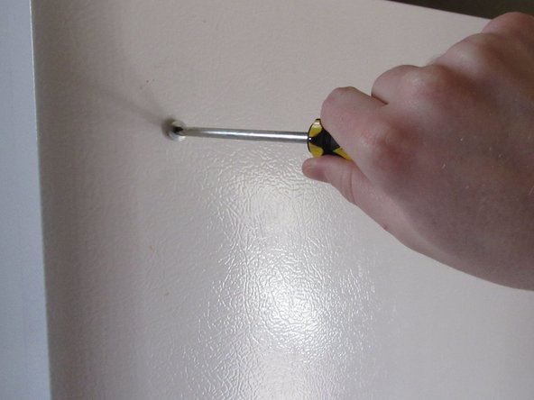

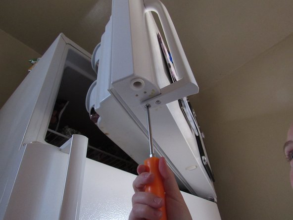

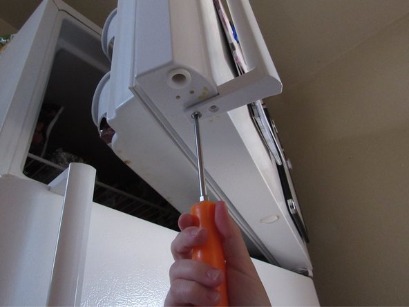

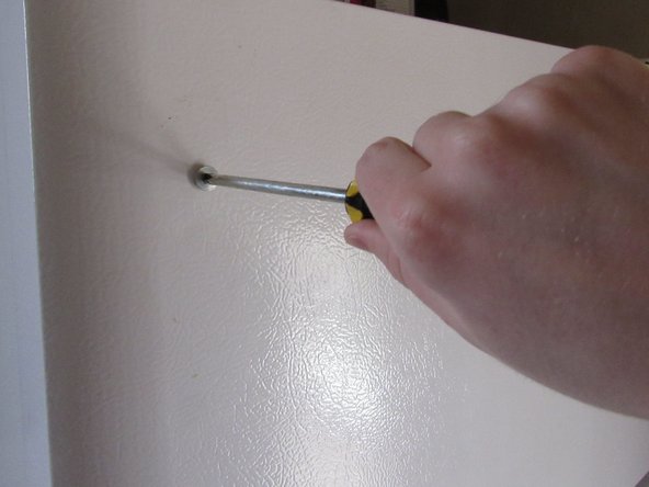

  1. Frigidaire FFHT2022AW Freezer Door Handle Replacement, Freezer Door Handle: adım 1, 2 resimden 1. Frigidaire FFHT2022AW Freezer Door Handle Replacement, Freezer Door Handle: adım 1, 2 resimden 2.
    • Remove the screws keeping the handle in place on the bottom face of the freezer door with a Phillips head screwdriver.
  2. Frigidaire FFHT2022AW Freezer Door Handle Replacement: adım 2, 3 resimden 1. Frigidaire FFHT2022AW Freezer Door Handle Replacement: adım 2, 3 resimden 2. Frigidaire FFHT2022AW Freezer Door Handle Replacement: adım 2, 3 resimden 3.
    • Remove any broken pieces of the original freezer handle.
    • Pushing up on any components attached to the handle mount connected to the bottom of the handle should remove anything still connected to the freezer.
    • Use caution when handling broken components.
