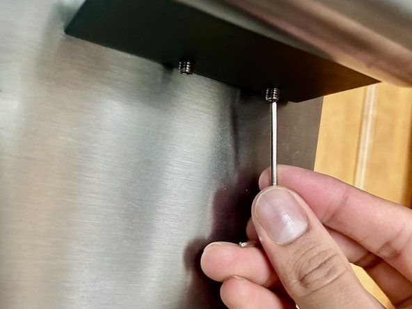

  1. Frigidaire FPBS2778UF5 Drawer Handle Replacement, Drawer Handle: adım 1, 2 resimden 1. Frigidaire FPBS2778UF5 Drawer Handle Replacement, Drawer Handle: adım 1, 2 resimden 2.
    • This is what the handle looks like when it's loose or is about to fall off.
  2. Frigidaire FPBS2778UF5 Drawer Handle Replacement: adım 2, 3 resimden 1. Frigidaire FPBS2778UF5 Drawer Handle Replacement: adım 2, 3 resimden 2. Frigidaire FPBS2778UF5 Drawer Handle Replacement: adım 2, 3 resimden 3.
    • Remove the four screws (two on each side) from beneath the handle using an Allen key.
    • You might need to press the Allen key hard inside for it to unscrew (if loosened).

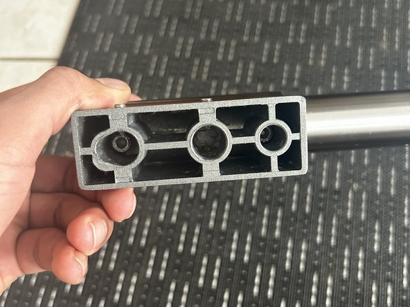

  3. Frigidaire FPBS2778UF5 Drawer Handle Replacement: adım 3, 2 resimden 1. Frigidaire FPBS2778UF5 Drawer Handle Replacement: adım 3, 2 resimden 2.
    • Make sure the nuts holding the handle are secure. Only use your hands to tighten them, as using a wrench might damage the fridge.
  4. Frigidaire FPBS2778UF5 Drawer Handle Replacement: adım 4, 3 resimden 1. Frigidaire FPBS2778UF5 Drawer Handle Replacement: adım 4, 3 resimden 2. Frigidaire FPBS2778UF5 Drawer Handle Replacement: adım 4, 3 resimden 3.
    • Ensure that the nuts are securely inside the handle. Keep them inside the entire time to make the process easier.
    • Make sure nothing is inside on both sides of the handle which may have been causing it to loosen up.

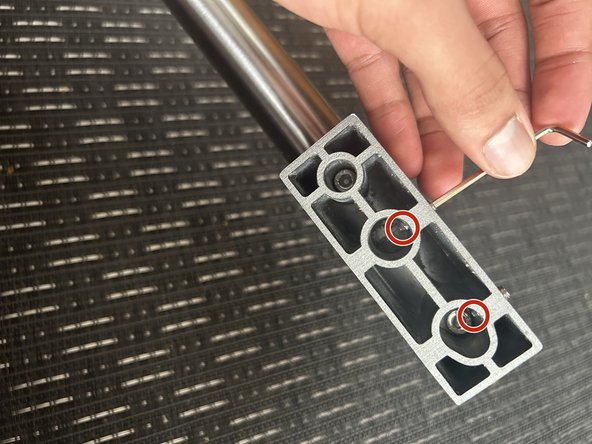

  6. Frigidaire FPBS2778UF5 Drawer Handle Replacement: adım 6, 3 resimden 1. Frigidaire FPBS2778UF5 Drawer Handle Replacement: adım 6, 3 resimden 2. Frigidaire FPBS2778UF5 Drawer Handle Replacement: adım 6, 3 resimden 3.
    • Loosen the nuts on both sides until they are not seen inside.
    • This will keep the holder stable on the fridge when it's screwed in.

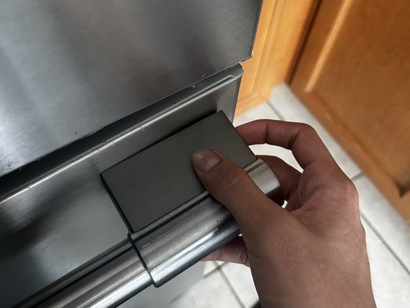

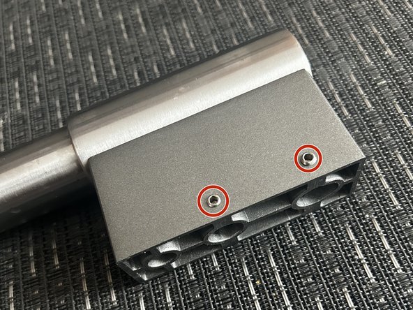

  7. Frigidaire FPBS2778UF5 Drawer Handle Replacement: adım 7, 3 resimden 1. Frigidaire FPBS2778UF5 Drawer Handle Replacement: adım 7, 3 resimden 2. Frigidaire FPBS2778UF5 Drawer Handle Replacement: adım 7, 3 resimden 3.
    • Correctly place the holder in the correct holes on both sides.
    • Hold the holder and press it firmly onto the fridge to keep it steady.
    • You may require another person for this step.
    • Start screwing it back in with the same Allen key.
  8. Frigidaire FPBS2778UF5 Drawer Handle Replacement: adım 8, 2 resimden 1. Frigidaire FPBS2778UF5 Drawer Handle Replacement: adım 8, 2 resimden 2.
    • Make sure the screws are tight.
