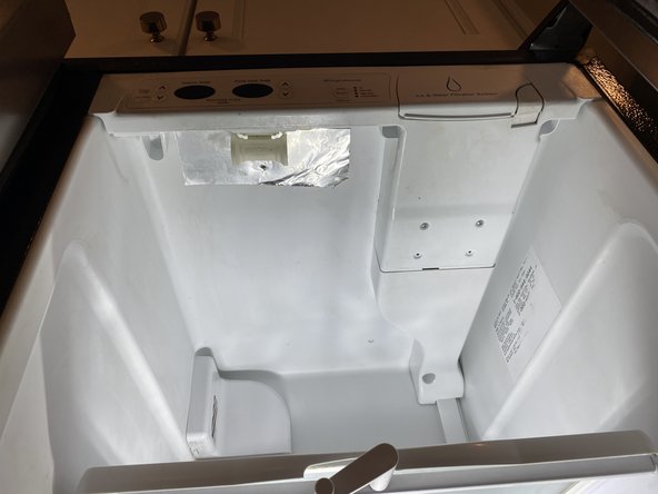

  2. Frigidaire Refrigerator Light Socket Replacement, Locate light socket: adım 2, 3 resimden 1. Frigidaire Refrigerator Light Socket Replacement, Locate light socket: adım 2, 3 resimden 2. Frigidaire Refrigerator Light Socket Replacement, Locate light socket: adım 2, 3 resimden 3.
    • Next, you will locate the light socket. In this instance, it is behind the control panel at the top of the fridge.
    • Remove the light bulbs from the receptacle.

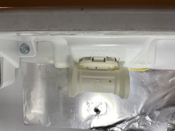

  3. Frigidaire Refrigerator Light Socket Replacement, Removing light socket: adım 3, 2 resimden 1. Frigidaire Refrigerator Light Socket Replacement, Removing light socket: adım 3, 2 resimden 2.
    • After light bulbs are removed, you will locate the small slit near the base of the light socket.
    • Insert the flathead screwdriver into the gap and turn it until the socket pops out.
    • Pull the socket out. It will still be attached to wires but there will be enough slack in them to pull out 4-6 inches.
  4. Frigidaire Refrigerator Light Socket Replacement, Disconnecting Electrical Fittings: adım 4, 2 resimden 1. Frigidaire Refrigerator Light Socket Replacement, Disconnecting Electrical Fittings: adım 4, 2 resimden 2.
    • Using the needle nose pliers, gently clamp the plastic fitting (not the wire) and wiggle the connections loose.
