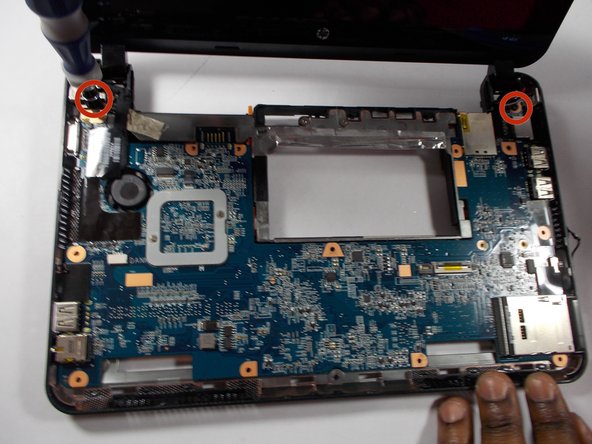

    3. HP Mini 210 Fan Replacement: adım 12, 2 resimden 1. HP Mini 210 Fan Replacement: adım 12, 2 resimden 2.
      • Use a screwdriver to remove the 9.3 mm screws on top of the motherboard.
