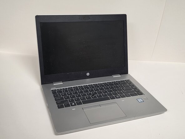

HP ProBook 640 G5 RAM Replacement

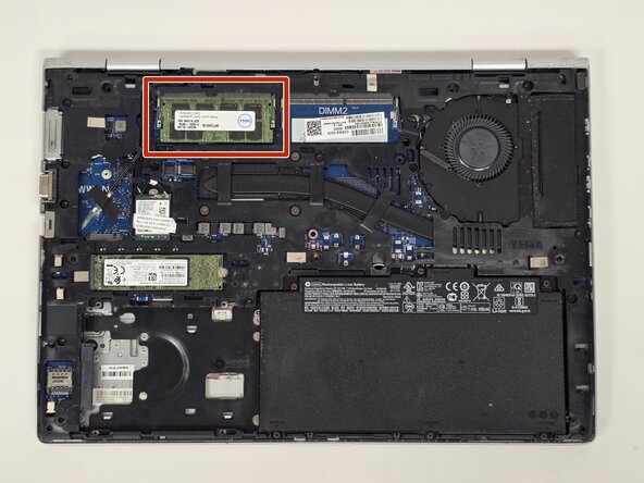

  3. HP ProBook 640 G5 RAM Replacement, RAM: adım 3, 1 resimden 1.
    • When replacing RAM, avoid touching the gold contacts and black chips. Handle the stick only by its outer edges or plastic/metal shielding. Touching the chips or gold contacts can introduce static electricity or oil from your fingers, potentially causing damage or poor connectivity.
    • Locate the RAM you intend on replacing/upgrading.
    • Some laptops may come with two sticks of RAM; the one we are working on is equipped with only one.

  4. HP ProBook 640 G5 RAM Replacement: adım 4, 1 resimden 1.
    • Gently push outward on the two retaining clips on each side of the module.
    • The RAM stick will pop up at a 30-degree angle.
    • Hold the RAM module by the edges (avoid touching the gold contacts).
    • Slide it out of the slot at the same angle it popped up.
