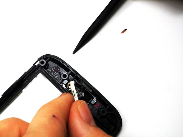

  6. HTC Excalibur Speakers Replacement, Speakers: adım 6, 1 resimden 1.
    • Remove the metal frame. Slip out the copper clips still attached to the bottom frame from the frame carefully.
