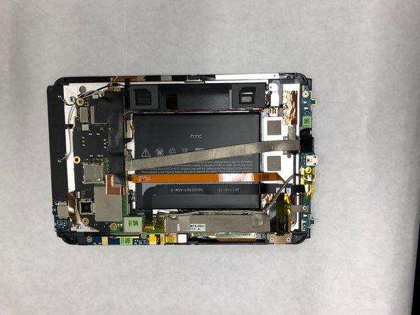

  4. HTC Flyer Charging Port Replacement: adım 4, 2 resimden 1. HTC Flyer Charging Port Replacement: adım 4, 2 resimden 2.
    • Remove the plastic top cover of the motherboard.

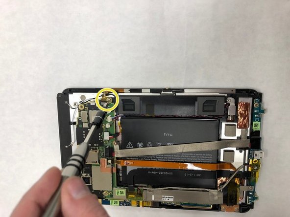

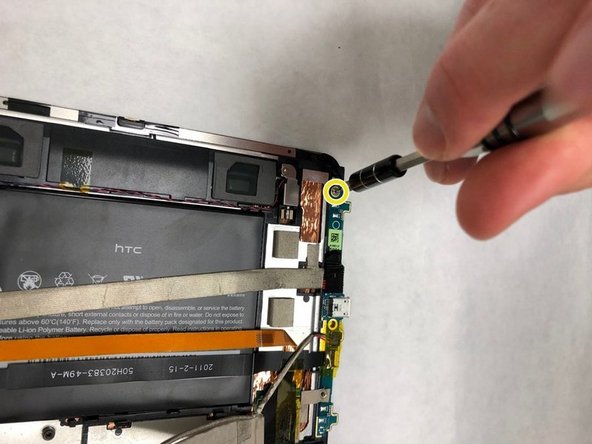

  5. HTC Flyer Charging Port Replacement: adım 5, 2 resimden 1. HTC Flyer Charging Port Replacement: adım 5, 2 resimden 2.
    • Remove four T5 Torx screws.

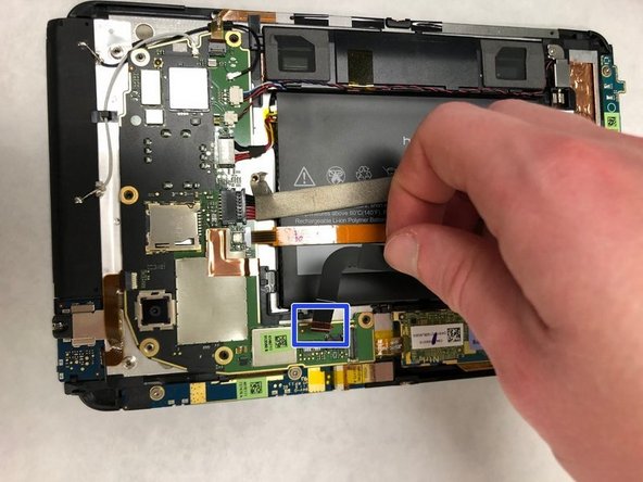

  6. HTC Flyer Charging Port Replacement: adım 6, 3 resimden 1. HTC Flyer Charging Port Replacement: adım 6, 3 resimden 2. HTC Flyer Charging Port Replacement: adım 6, 3 resimden 3.
    • Remove twelve of the connectors.

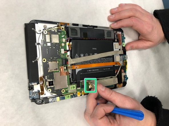

  7. HTC Flyer Charging Port Replacement: adım 7, 2 resimden 1. HTC Flyer Charging Port Replacement: adım 7, 2 resimden 2.
    • Release the flex-screen touch cable. It is held in place with clips. Use the safe open pry tool to unclip it. Note that it will still be connected to the base and the motherboard.

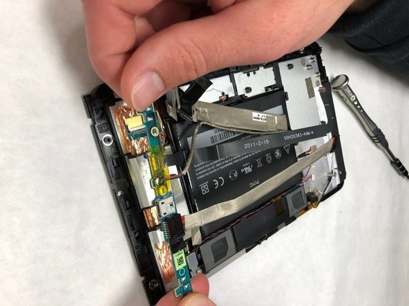

  12. HTC Flyer Charging Port Replacement: adım 12, 2 resimden 1. HTC Flyer Charging Port Replacement: adım 12, 2 resimden 2.
    • Remove the dock port flex cable. It will be tangled around other cables, so take care not to rip it while removing.
