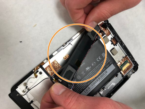

  8. HTC Flyer Screen Replacement: adım 8, 3 resimden 1. HTC Flyer Screen Replacement: adım 8, 3 resimden 2. HTC Flyer Screen Replacement: adım 8, 3 resimden 3.
    • Wedge the flat end of a spudger inbetween the battery and the front panel assembly.
    • Run the flat end of a spudger along the top edge of the battery to separate it from the adhesive securing it to the front panel assembly.
    • If you encounter any resistance from the remaining adhesive, simply use the flat end of a spudger to remove the excess adhesive.

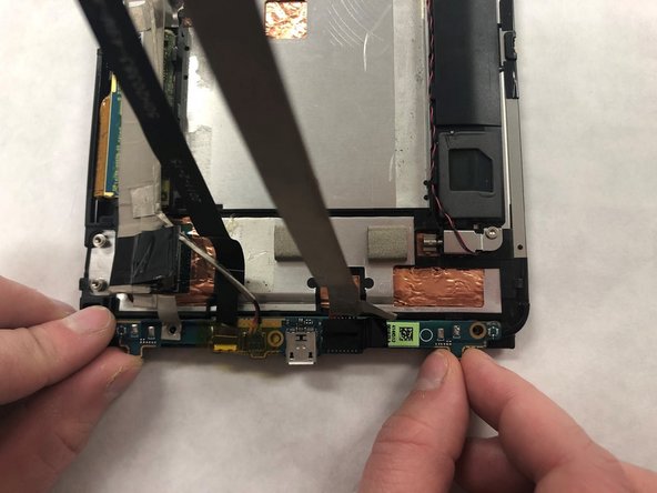

  15. HTC Flyer Screen Replacement, Screen: adım 15, 2 resimden 1. HTC Flyer Screen Replacement, Screen: adım 15, 2 resimden 2.
    • Remove lower flex cable and LCD flex cable. They are attached and will be removed as one piece.

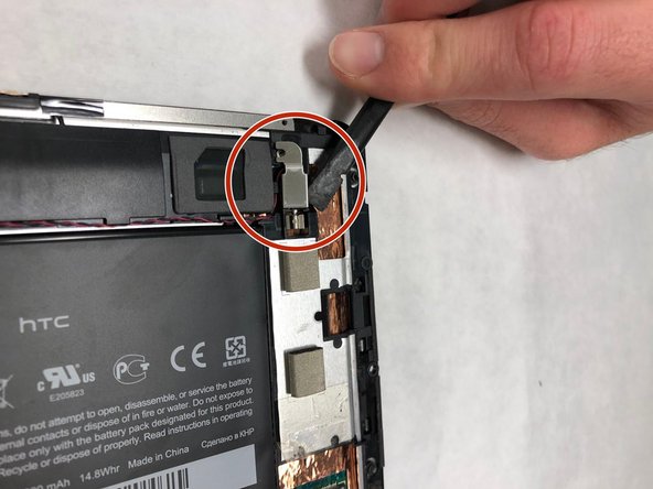

  17. HTC Flyer Screen Replacement: adım 17, 2 resimden 1. HTC Flyer Screen Replacement: adım 17, 2 resimden 2.
    • Lift casing away from vibrate motor.

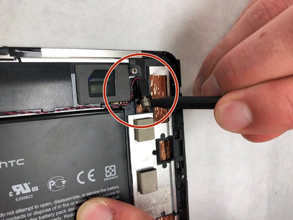

  18. HTC Flyer Screen Replacement: adım 18, 3 resimden 1. HTC Flyer Screen Replacement: adım 18, 3 resimden 2. HTC Flyer Screen Replacement: adım 18, 3 resimden 3.
    • Lift away vibrate motor.
    • Lift away speaker assembly. They should be attached and will be removed as one piece.

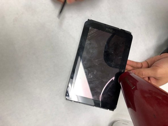

  19. HTC Flyer Screen Replacement: adım 19, 1 resimden 1.
    • Flip tablet and use hairdryer to heat the outside edges of the screen. Heat the edges for about 45 seconds using quick arm movement with the hair dryer set to high.
    • Heat for longer if necessary.

  20. HTC Flyer Screen Replacement: adım 20, 3 resimden 1. HTC Flyer Screen Replacement: adım 20, 3 resimden 2. HTC Flyer Screen Replacement: adım 20, 3 resimden 3.
    • Release the adhesive around the edges of the screen with a safe open pry tool. Continue to reheat the adhesive as needed.
