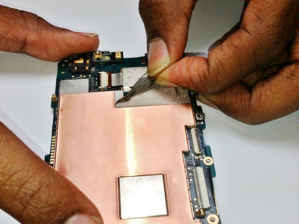

    • Remove the six Phillips screws from the perimeter of the rear frame.
    • By removing the screw with the "void" sticker on it, your Thunderbolt will no longer be covered under warranty.

  13. HTC Thunderbolt Camera Replacement: adım 13, 2 resimden 1. HTC Thunderbolt Camera Replacement: adım 13, 2 resimden 2.
    • Lifting from the side where the ribbon was disconnected, flip over the motherboard.
    • Remove the black tape covering the tabs connecting the motherboard and LCD.
  14. HTC Thunderbolt Camera Replacement: adım 14, 1 resimden 1.
    • Using the plastic opening tool pop up the two tabs connecting the LCD and motherboard.
  15. HTC Thunderbolt Camera Replacement: adım 15, 2 resimden 1. HTC Thunderbolt Camera Replacement: adım 15, 2 resimden 2.
    • Once the tabs have been popped up, slowly pull the two pieces away from each other.
    • If there is resistance pulling apart the phone then a ribbon or tab has not been disconnected properly/completely.

  17. HTC Thunderbolt Camera Replacement, Camera: adım 17, 2 resimden 1. HTC Thunderbolt Camera Replacement, Camera: adım 17, 2 resimden 2.
    • Use a finger nail to get in between the tape and the phone, then pull the tape off gently.
  18. HTC Thunderbolt Camera Replacement: adım 18, 1 resimden 1.
    • Pop up the tab connecting the camera to the motherboard.
  19. HTC Thunderbolt Camera Replacement: adım 19, 1 resimden 1.
    Bu adımda kullanılan alet:
    • Flip over motherboard and using tweezers gently grab the camera, then pull back and up.
