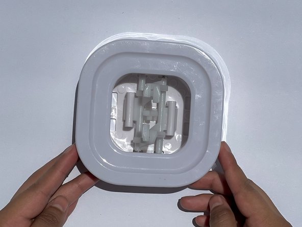

  1. How to Disassemble an OXO Container Lid for Cleaning, How to Disassemble an OXO Container Lid for Cleaning: adım 1, 2 resimden 1. How to Disassemble an OXO Container Lid for Cleaning, How to Disassemble an OXO Container Lid for Cleaning: adım 1, 2 resimden 2.
    • Twist the bottom piece off by following the directions displayed on the lid.
    • Once inside, remove the outer layer seal from the lid by pulling it straight up.
  2. How to Disassemble an OXO Container Lid for Cleaning: adım 2, 3 resimden 1. How to Disassemble an OXO Container Lid for Cleaning: adım 2, 3 resimden 2. How to Disassemble an OXO Container Lid for Cleaning: adım 2, 3 resimden 3.
    • Flip the lid so the button faces up. Then remove the button from the base of the lid.
    • This requires more added force.
    • Separate the interior prongs.
  3. How to Disassemble an OXO Container Lid for Cleaning: adım 3, 2 resimden 1. How to Disassemble an OXO Container Lid for Cleaning: adım 3, 2 resimden 2.
    • After separating the prongs, the spring and the circular spring cap will separate from the square frame with little force.
    • With some force, remove the two prongs from the base of the lid by snapping them out of the bracket. Be careful not to break the bracket's small prongs.
    • The disassembled parts can now be cleaned with warm, soapy water.
  4. How to Disassemble an OXO Container Lid for Cleaning: adım 4, 2 resimden 1. How to Disassemble an OXO Container Lid for Cleaning: adım 4, 2 resimden 2.
    • To reassemble the lid, start by connecting the outer layer piece with the base piece. Grooves in the parts will only allow them to be connected in the correct way.
    • Place the spring in the center of the lid within the circular outline.
  5. How to Disassemble an OXO Container Lid for Cleaning: adım 5, 1 resimden 1.
    • Take the small interior circle and place it on top of the spring.
    • Use force to push this piece down. Make sure the slots align.
    • This piece will not stay in place on its own. Flip the lid over and keep it on a flat surface to prevent the spring from releasing.
  6. How to Disassemble an OXO Container Lid for Cleaning: adım 6, 2 resimden 1. How to Disassemble an OXO Container Lid for Cleaning: adım 6, 2 resimden 2.
    • Reattach the two prongs to the lid.
    • Intertwine the two prongs together.
    • The spring should now be firmly held in place.
  7. How to Disassemble an OXO Container Lid for Cleaning: adım 7, 2 resimden 1. How to Disassemble an OXO Container Lid for Cleaning: adım 7, 2 resimden 2.
    • Twist the bottom piece back on the lid.
    • Reattach the button to the center of the lid.

Excellent guide, a set I got came with the metal pins of the prongs unseated from their holes, causing the lid to operate incorrectly. I was able to re-seat them and get the lid working with the help of this.
