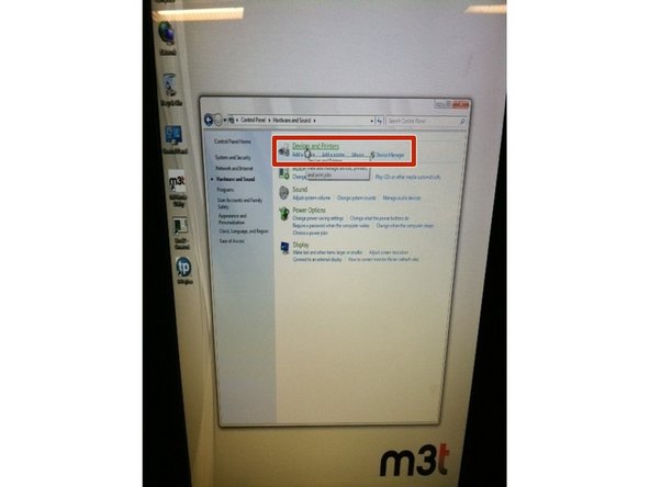

  9. How to Program a M3t Kiosk, Printer Part 2: adım 9, 3 resimden 1. How to Program a M3t Kiosk, Printer Part 2: adım 9, 3 resimden 2. How to Program a M3t Kiosk, Printer Part 2: adım 9, 3 resimden 3.
    • Select Hardware and Sound.
    • Select Devices and Printers.

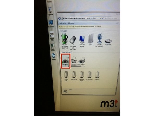

    • Double Click on Custom VKP80 II.

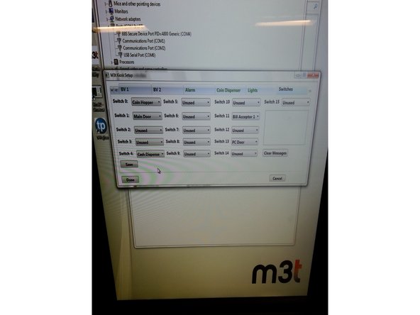

  12. How to Program a M3t Kiosk, Lights and Switches: adım 12, 2 resimden 1. How to Program a M3t Kiosk, Lights and Switches: adım 12, 2 resimden 2.
    • Under both the Lights and Switches tabs don’t change anything and save.
