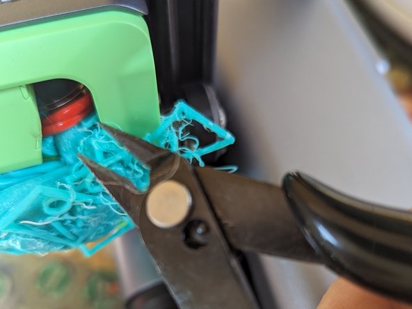

  3. How to Remove a Blob from an AnkerMake M5 3D Printer, Clear Blob Chunks to Remove Extruder Housing Trim: adım 3, 3 resimden 1. How to Remove a Blob from an AnkerMake M5 3D Printer, Clear Blob Chunks to Remove Extruder Housing Trim: adım 3, 3 resimden 2. How to Remove a Blob from an AnkerMake M5 3D Printer, Clear Blob Chunks to Remove Extruder Housing Trim: adım 3, 3 resimden 3.
    • Use clippers to remove the blobs in order to remove the extruder housing rim.

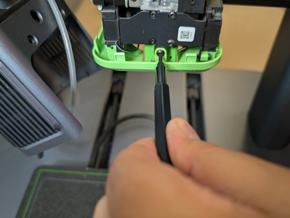

  6. How to Remove a Blob from an AnkerMake M5 3D Printer, Remove the Trim Screws: adım 6, 2 resimden 1. How to Remove a Blob from an AnkerMake M5 3D Printer, Remove the Trim Screws: adım 6, 2 resimden 2.
    • Use the Phillips #00 Screwdriver to remove the screws from the housing of the nozzle.
  7. How to Remove a Blob from an AnkerMake M5 3D Printer, Remove Extruder Housing Trim: adım 7, 2 resimden 1. How to Remove a Blob from an AnkerMake M5 3D Printer, Remove Extruder Housing Trim: adım 7, 2 resimden 2.
    • After the screws have been removed, the housing comes off by pulling down.
