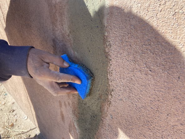

  5. How to Repair Cracks in a Cement Wall: adım 5, 2 resimden 1. How to Repair Cracks in a Cement Wall: adım 5, 2 resimden 2.
    • Wet the sponge and begin slightly tapping the newly plastered area.
    • Moisten the area until the entire boxed in area is damp.

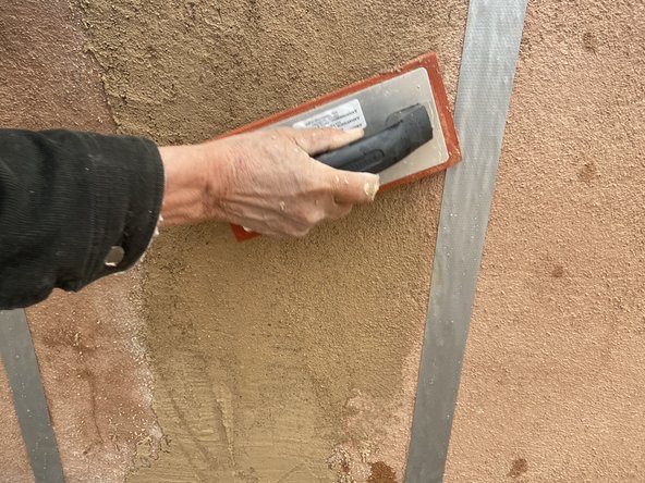

  6. How to Repair Cracks in a Cement Wall: adım 6, 3 resimden 1. How to Repair Cracks in a Cement Wall: adım 6, 3 resimden 2. How to Repair Cracks in a Cement Wall: adım 6, 3 resimden 3.
    • Add stucco finish with the tile trowel.
    • Once the cemented area is covered with the stucco finish, take the foam plastering trowel and spread stucco finish to the edges of the tape.
    • If the trowel is too dry to spread the finish, moisten it with the water from earlier.
    • Blend the finish into the surrounding tape.
