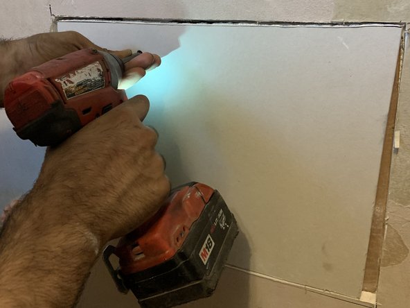

    • Measure the distance between the nearest studs on either side of the hole using a tape measure.
    • Trace a rectangular/square shape around the hole in pencil.
    • Use a box cutter to cut along the lines, making the hole into an even rectangular/square shape.
  2. How to Repair a Large Wall Hole Using Drywall: adım 2, 1 resimden 1.
    • Use the tape measure to measure the drywall to fit the dimensions of the hole trimmed in Step 1.
    • Cut out the section of drywall with the box cutter.
    • Measure out the two pieces of wood using the tape measure. These strips of wood should be just a few inches longer than the length of the hole.
    • Cut the pieces of wood to the desired length with the hand saw.
  3. How to Repair a Large Wall Hole Using Drywall: adım 4, 1 resimden 1.
    • Place the two pieces of wood vertically inside the hole.
    • Use a Phillips flat head drill bit to drill 6x2 mm drywall screws into the two pieces of wood to the inside of the hole.
  4. How to Repair a Large Wall Hole Using Drywall: adım 5, 2 resimden 1. How to Repair a Large Wall Hole Using Drywall: adım 5, 2 resimden 2.
    • Place the section of drywall you cut in Step 2 into the hole.
    • The section of drywall should fit inside the hole snugly. The margins do not have to fit perfectly, but there should be no larger than a 1/8 inch gap between the dry wall and the edges of the hole.
    • Screw the drywall into the pieces of wood.
    • Make sure to screw in the corners of the drywall to ensure stability.
  5. How to Repair a Large Wall Hole Using Drywall: adım 6, 1 resimden 1.
    • Cut pieces of drywall mesh tape so that they will cleanly cover the gaps between the drywall and the hole.
    • Apply the pieces of dry wall mesh tape to the seams.
  6. How to Repair a Large Wall Hole Using Drywall: adım 7, 1 resimden 1.
    • Apply drywall filler over the mesh tape and the holes left by the screws using a putty knife.
  7. How to Repair a Large Wall Hole Using Drywall: adım 8, 1 resimden 1.
    • After the surface is completely dry, smooth out the wall with sandpaper.
    • Paint the wall the color of your choice.
