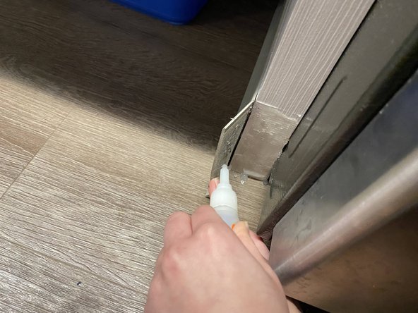

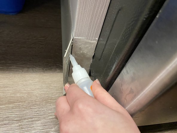

  3. How to Replace Vinyl Baseboard: adım 3, 3 resimden 1. How to Replace Vinyl Baseboard: adım 3, 3 resimden 2. How to Replace Vinyl Baseboard: adım 3, 3 resimden 3.
    • Using a pen, draw a zig-zag shape where the glue will go on the baseboard, starting from the top and continuing to the bottom of the board.
    • Apply the glue/adhesive to the line drawn.
    • Ensuring the baseboard is fully covered with adhesive will prevent the board from coming off in the future.

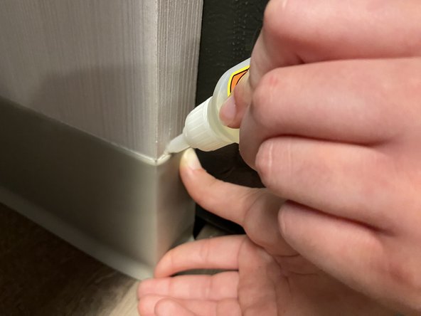

  4. How to Replace Vinyl Baseboard: adım 4, 2 resimden 1. How to Replace Vinyl Baseboard: adım 4, 2 resimden 2.
    • Press the baseboard lining against the wall and flatten it until there are no gaps between the baseboard and the wall.
    • Hold the baseboard against the wall for 2 minutes before moving to step 5.
    • Make sure the glue is not leaking (overflowing) and ensure that all areas are covered.
    • More adhesive can be added if there are areas not covered.

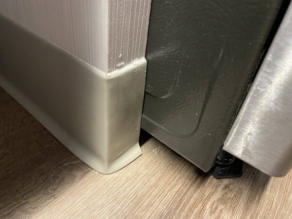

  5. How to Replace Vinyl Baseboard: adım 5, 1 resimden 1.
    • Press weights against the wall for 2 minutes, making sure the weight is leaning against the flat surface of your board.
    • Leave the weights against the wall for at least 30 minutes.
    • The exact time that you leave the weight pressed against the wall varies. Leave the weight on as long as it takes the adhesive to dry. If you are unsure, refer to the product label of your adhesive to find the necessary drying time.
  6. How to Replace Vinyl Baseboard: adım 6, 2 resimden 1. How to Replace Vinyl Baseboard: adım 6, 2 resimden 2.
    • Remove the weight from the wall and check if the adhesive has completely dried. This can be done by trying to move the baseboard.
    • If dry, use a small piece of damp cloth to remove any leftover residue from the wall and outer side of the baseboard.
    • If the adhesive has not dried, reapply the weight to the wall and give it another 15 minutes, then complete step 6.
