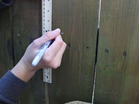

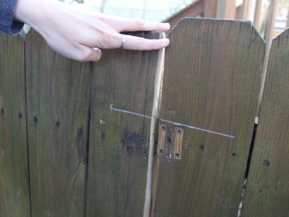

    • Using a ruler and a sharpie, draw a line starting at the bottom corner of the gate to the top corner of the gate, to ensure it is parallel with the rest of the gate.

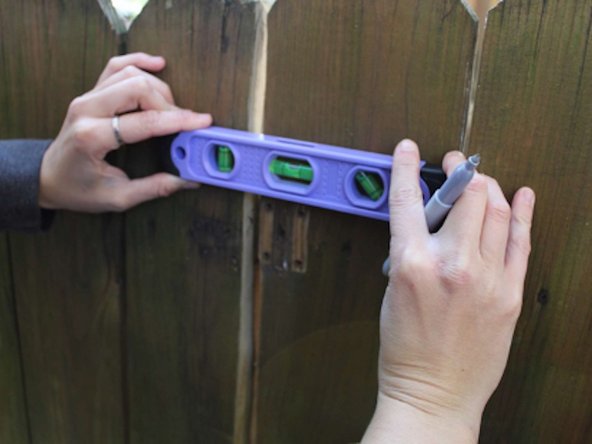

    • Place a level on the gate to ensure that the gate is properly level.

    • Using a ruler, measure 6 inches down from the top of the gate and mark that spot using a sharpie.
