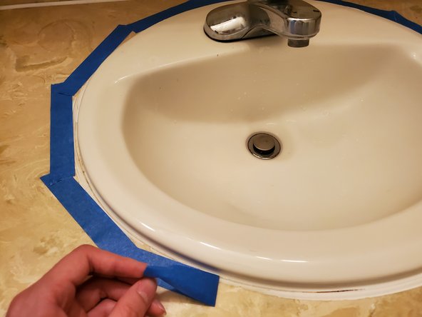

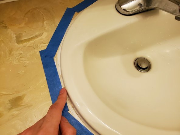

  4. How to re-caulk a bathroom sink: adım 4, 3 resimden 1. How to re-caulk a bathroom sink: adım 4, 3 resimden 2. How to re-caulk a bathroom sink: adım 4, 3 resimden 3.
    • Apply painter's tape around the rim of the sink while leaving a small gap for caulk to be applied.
