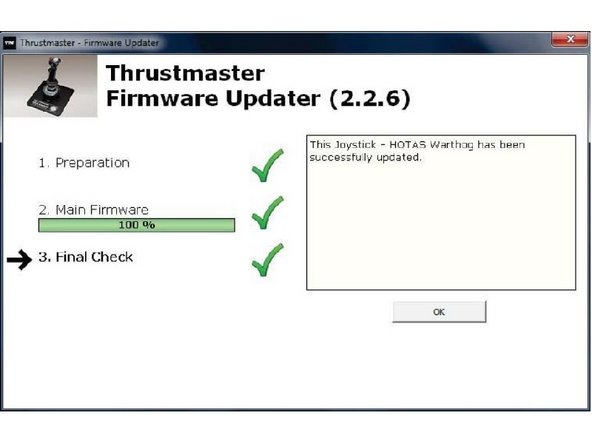

  5. How to replace the main PCB, Update the firmware: adım 5, 3 resimden 1. How to replace the main PCB, Update the firmware: adım 5, 3 resimden 2. How to replace the main PCB, Update the firmware: adım 5, 3 resimden 3.
    • (First picture) Your device appears in the firmware updater. Apply the update by clicking on "OK".
    • (Second picture) The update is in progress.
    • (Third picture) The update is done ! You can close the firmware updater by clicking on the arrow at the top right corner.
