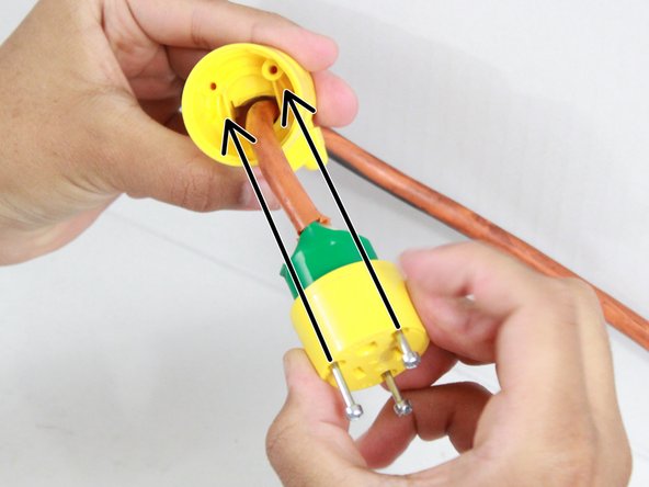

    • Install an Extension Cord Female Plug is a relatively simple process that anyone can do at home. This is the cord that we will repair.
    • Disconnect the cable before carrying out any repair work.
    • Use a utility knife to cleanly cut from the middle and around the cable.
  2. Install an Extension Cord Female Plug: adım 2, 3 resimden 1. Install an Extension Cord Female Plug: adım 2, 3 resimden 2. Install an Extension Cord Female Plug: adım 2, 3 resimden 3.
    • Use wire strippers to remove about 2 cm from the inner wires
  3. Install an Extension Cord Female Plug: adım 3, 2 resimden 1. Install an Extension Cord Female Plug: adım 3, 2 resimden 2.
    • Make sure you put the bottom cover of the female plug.
  4. Install an Extension Cord Female Plug: adım 4, 3 resimden 1. Install an Extension Cord Female Plug: adım 4, 3 resimden 2. Install an Extension Cord Female Plug: adım 4, 3 resimden 3.
    • The green screw is for the (green wire), the gold screw is for the (black wire), and the silver screw is for the (white wire).
    • For green wire.
    • For black wire
    • For white wire.
    • Now when you have each wire inside the hole you tighten the three screws.
  5. Install an Extension Cord Female Plug: adım 5, 3 resimden 1. Install an Extension Cord Female Plug: adım 5, 3 resimden 2. Install an Extension Cord Female Plug: adım 5, 3 resimden 3.
    • Electrical tape is optional.
    • Need to make sure both of the parts are lined up in the same directions.
    • Push both parts together and you would see the screws pop up.

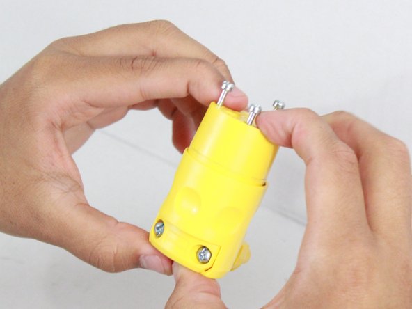

  6. Install an Extension Cord Female Plug: adım 6, 3 resimden 1. Install an Extension Cord Female Plug: adım 6, 3 resimden 2. Install an Extension Cord Female Plug: adım 6, 3 resimden 3.
    • Tightening the top three screws.
    • Also, need to tighten the two bottom screws.
    • Make sure you have one or two fingers in the back of the two screws so they pop up.

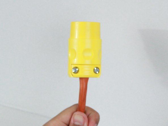

  7. Install an Extension Cord Female Plug: adım 7, 1 resimden 1.
    • Test out.
