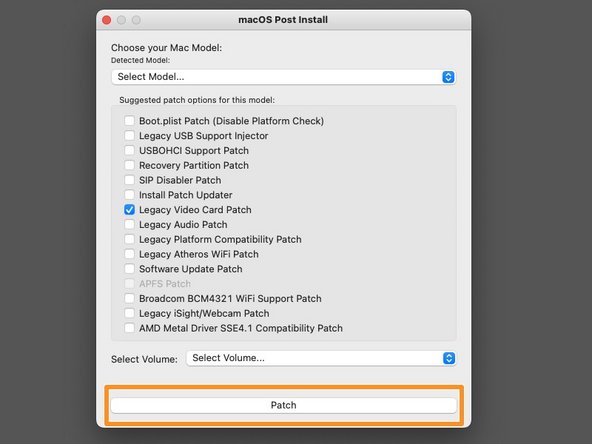

    • Once the installation does complete, open macOS Post Install
  12. Installing older versions of macOS Guide #4 Continued: adım 12, 2 resimden 1. Installing older versions of macOS Guide #4 Continued: adım 12, 2 resimden 2.
    • Instead of applying all patches available, OpenCore patches most of these on its own, and therefore you do not need to apply more.
    • Choose your Mac model and apply only the "Legacy Video Card" patch.
    • Click patch and reboot the Mac.
