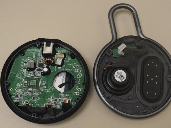

  4. JBL Clip 3 Button Board Replacement: adım 4, 2 resimden 1. JBL Clip 3 Button Board Replacement: adım 4, 2 resimden 2.
    • Carefully remove the 2-pin and 4-pin connectors from the motherboard.
    • Tweezers can also be used to remove the 2-pin and 4-pin connectors.
