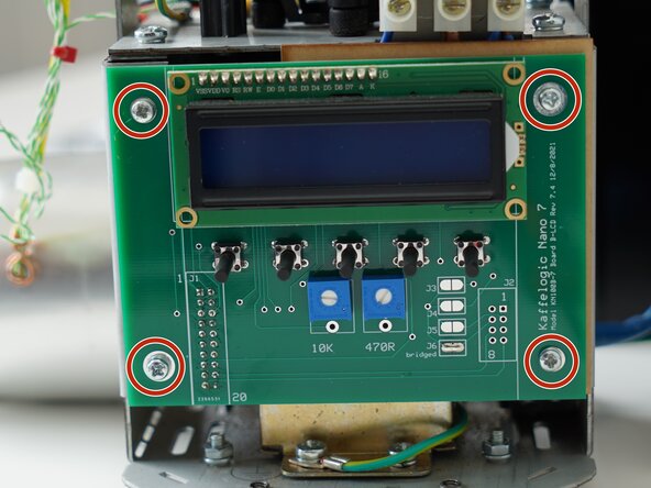

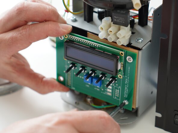

  6. Kaffelogic Nano 7/LINK (A/B/C-N Serial) LCD Board Replacement, Remove PCB screws: adım 6, 3 resimden 1. Kaffelogic Nano 7/LINK (A/B/C-N Serial) LCD Board Replacement, Remove PCB screws: adım 6, 3 resimden 2. Kaffelogic Nano 7/LINK (A/B/C-N Serial) LCD Board Replacement, Remove PCB screws: adım 6, 3 resimden 3.
    • Remove the 4x PH2 screws securing the display board to the chassis.
    • If your ribbon cable is mounted on the front, disconnect it before unscrewing the PCB.

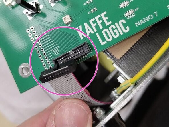

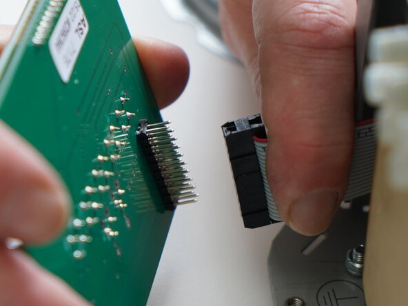

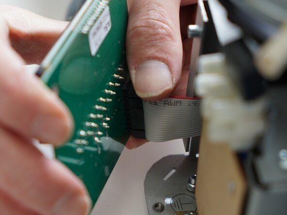

  7. Kaffelogic Nano 7/LINK (A/B/C-N Serial) LCD Board Replacement, Remove ribbon connector: adım 7, 2 resimden 1. Kaffelogic Nano 7/LINK (A/B/C-N Serial) LCD Board Replacement, Remove ribbon connector: adım 7, 2 resimden 2.
    • Pull carefully on the ribbon connector to remove it.
