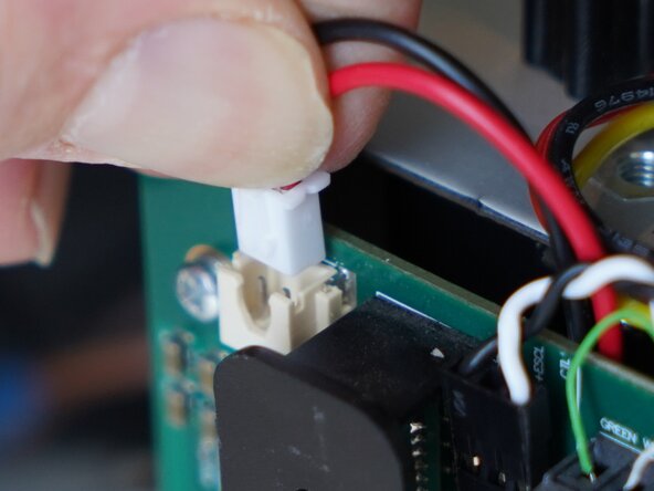

  7. Kaffelogic Nano 7/LINK (A/B/C-N Serial) Mainboard Replacement, Disconnect the SSR signal: adım 7, 2 resimden 1. Kaffelogic Nano 7/LINK (A/B/C-N Serial) Mainboard Replacement, Disconnect the SSR signal: adım 7, 2 resimden 2.
    • Pull upwards on the SSR signal connector to remove it.

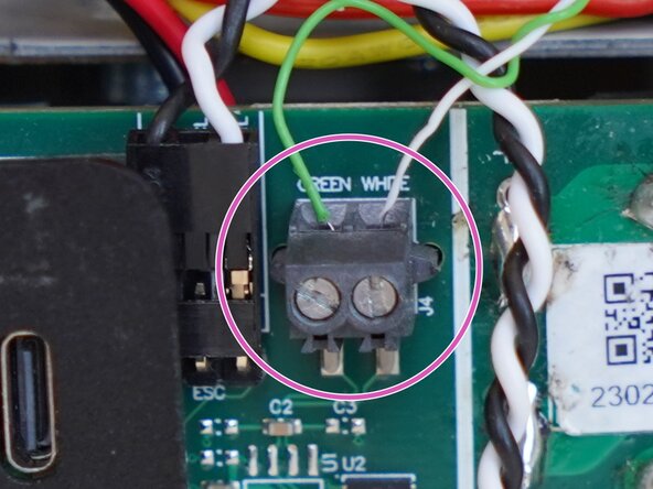

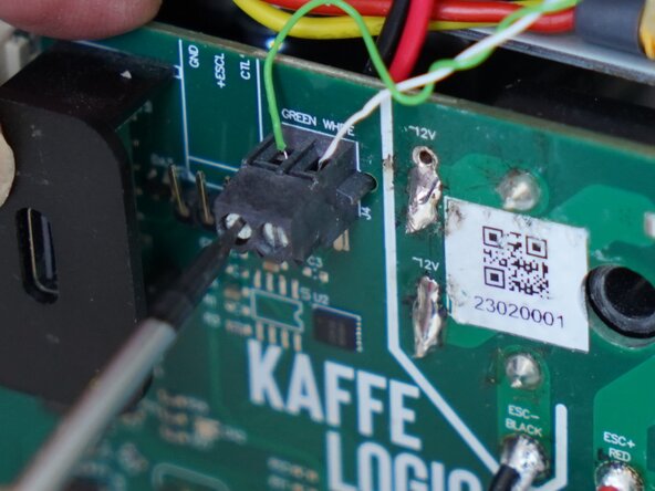

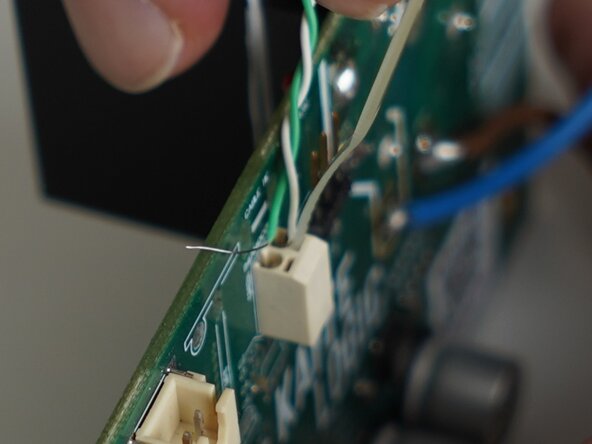

  8. Kaffelogic Nano 7/LINK (A/B/C-N Serial) Mainboard Replacement, Disconnect the thermocouple: adım 8, 2 resimden 1. Kaffelogic Nano 7/LINK (A/B/C-N Serial) Mainboard Replacement, Disconnect the thermocouple: adım 8, 2 resimden 2.
    • Use a 2.0mm slotted screwdriver to remove the thermocouple wires from the PCB-A
  9. Kaffelogic Nano 7/LINK (A/B/C-N Serial) Mainboard Replacement, White thermocouple connector: adım 9, 3 resimden 1. Kaffelogic Nano 7/LINK (A/B/C-N Serial) Mainboard Replacement, White thermocouple connector: adım 9, 3 resimden 2. Kaffelogic Nano 7/LINK (A/B/C-N Serial) Mainboard Replacement, White thermocouple connector: adım 9, 3 resimden 3.
    • If your thermocouple connector looks like this, you will need to follow this step.
    • Use the end of a cable tie or very small plastic spudger to open the contact and remove your thermocouple wires. You may need to trim the cable tie end to fit into the slot.

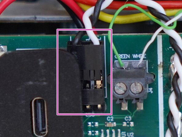

  10. Kaffelogic Nano 7/LINK (A/B/C-N Serial) Mainboard Replacement, Remove motor controller signal: adım 10, 2 resimden 1. Kaffelogic Nano 7/LINK (A/B/C-N Serial) Mainboard Replacement, Remove motor controller signal: adım 10, 2 resimden 2.
    • (Applicable to early models) Pull upwards on the motor controller signal connector to remove it.
    • Black wire to the left when replacing.

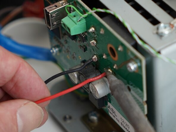

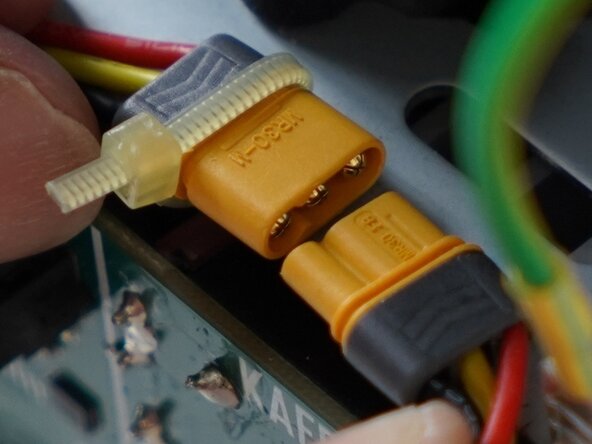

  11. Kaffelogic Nano 7/LINK (A/B/C-N Serial) Mainboard Replacement, Disconnect/desolder the motor: adım 11, 2 resimden 1. Kaffelogic Nano 7/LINK (A/B/C-N Serial) Mainboard Replacement, Disconnect/desolder the motor: adım 11, 2 resimden 2.
    • Unplug your motor if your roaster is fitted with a connector, otherwise de-solder the motor controller power.

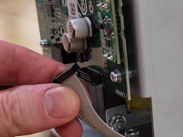

  12. Kaffelogic Nano 7/LINK (A/B/C-N Serial) Mainboard Replacement, Disconnect the ribbon cable: adım 12, 1 resimden 1.
    • Carefully pull on the ribbon cable to remove it.
    • Some boards have a larger cable on the other side of the PCB.

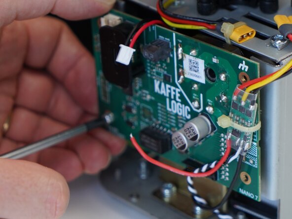

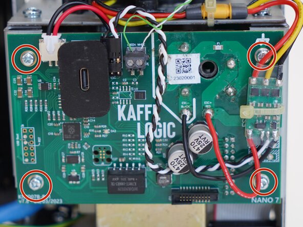

  13. Kaffelogic Nano 7/LINK (A/B/C-N Serial) Mainboard Replacement, Remove PCB screws: adım 13, 2 resimden 1. Kaffelogic Nano 7/LINK (A/B/C-N Serial) Mainboard Replacement, Remove PCB screws: adım 13, 2 resimden 2.
    • Remove the 4x PH2 PCB screws.

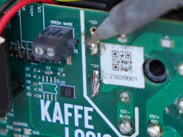

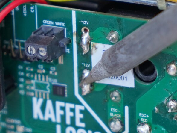

  14. Kaffelogic Nano 7/LINK (A/B/C-N Serial) Mainboard Replacement, De-solder the power wires: adım 14, 2 resimden 1. Kaffelogic Nano 7/LINK (A/B/C-N Serial) Mainboard Replacement, De-solder the power wires: adım 14, 2 resimden 2.
    • Prepare your soldering iron and de-solder/reflow the two transformer wires to remove them.
