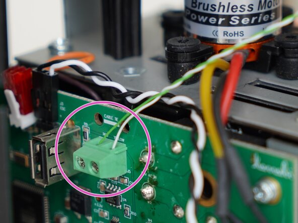

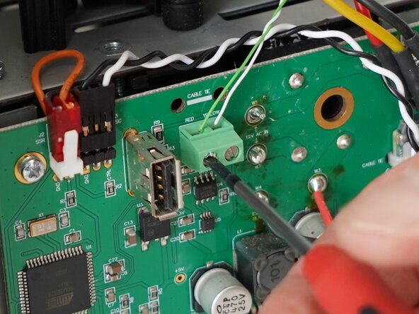

  6. Kaffelogic Nano 7/LINK (A/B/C-N Serial) Thermocouple Replacement, Disconnect the thermocouple: adım 6, 3 resimden 1. Kaffelogic Nano 7/LINK (A/B/C-N Serial) Thermocouple Replacement, Disconnect the thermocouple: adım 6, 3 resimden 2. Kaffelogic Nano 7/LINK (A/B/C-N Serial) Thermocouple Replacement, Disconnect the thermocouple: adım 6, 3 resimden 3.
    • Use a 2.0mm slotted screwdriver to remove the thermocouple wires from the PCB-A

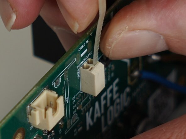

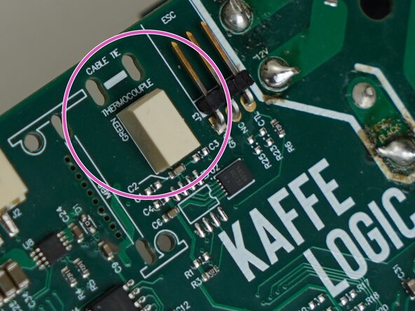

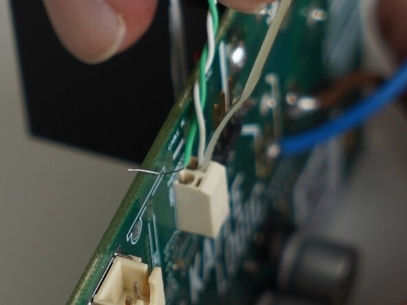

  7. Kaffelogic Nano 7/LINK (A/B/C-N Serial) Thermocouple Replacement, White thermocouple connector: adım 7, 3 resimden 1. Kaffelogic Nano 7/LINK (A/B/C-N Serial) Thermocouple Replacement, White thermocouple connector: adım 7, 3 resimden 2. Kaffelogic Nano 7/LINK (A/B/C-N Serial) Thermocouple Replacement, White thermocouple connector: adım 7, 3 resimden 3.
    • If your thermocouple connector looks like this, you will need to follow this step.
    • Use the end of a cable tie or very small plastic spudger to open the contact and remove/insert your thermocouple wires. You may need to trim the cable tie end to fit into the slot.

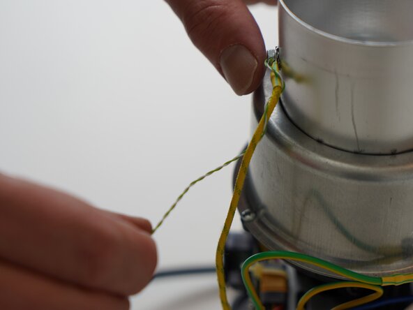

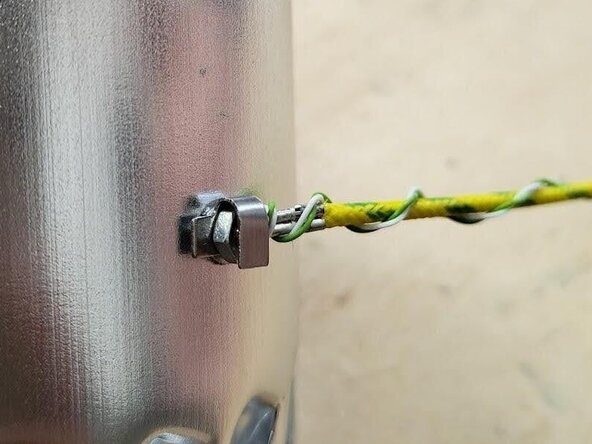

  8. Kaffelogic Nano 7/LINK (A/B/C-N Serial) Thermocouple Replacement, Unwrap/unfold thermocouple fixing: adım 8, 2 resimden 1. Kaffelogic Nano 7/LINK (A/B/C-N Serial) Thermocouple Replacement, Unwrap/unfold thermocouple fixing: adım 8, 2 resimden 2.
    • Carefully unwrap the copper wire used to secure the thermocouple.
    • Later models feature a reusable folded tab, in-place of the copper wire wrap.

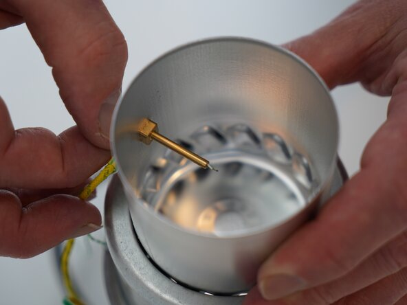

  9. Kaffelogic Nano 7/LINK (A/B/C-N Serial) Thermocouple Replacement, Removing the thermocouple: adım 9, 3 resimden 1. Kaffelogic Nano 7/LINK (A/B/C-N Serial) Thermocouple Replacement, Removing the thermocouple: adım 9, 3 resimden 2. Kaffelogic Nano 7/LINK (A/B/C-N Serial) Thermocouple Replacement, Removing the thermocouple: adım 9, 3 resimden 3.
    • Unwind the thermocouple wire from the earth lead, cut any cable ties used to secure excess wire.
    • Pinch the thermocouple and gently remove it from the tube.
