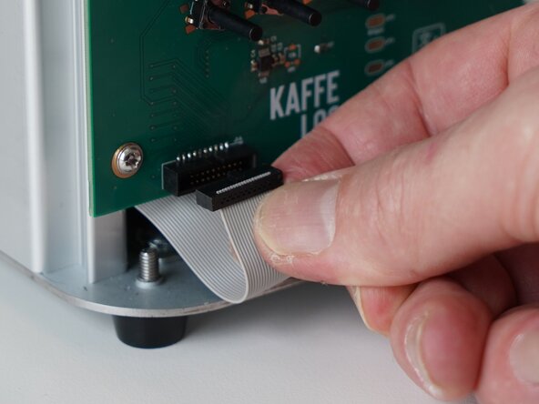

  6. Kaffelogic Nano 7/LINK (D-P Serial) LCD Board Replacement, Remove ribbon cable: adım 6, 3 resimden 1. Kaffelogic Nano 7/LINK (D-P Serial) LCD Board Replacement, Remove ribbon cable: adım 6, 3 resimden 2. Kaffelogic Nano 7/LINK (D-P Serial) LCD Board Replacement, Remove ribbon cable: adım 6, 3 resimden 3.
    • Gently remove the ribbon cable from the PCB.

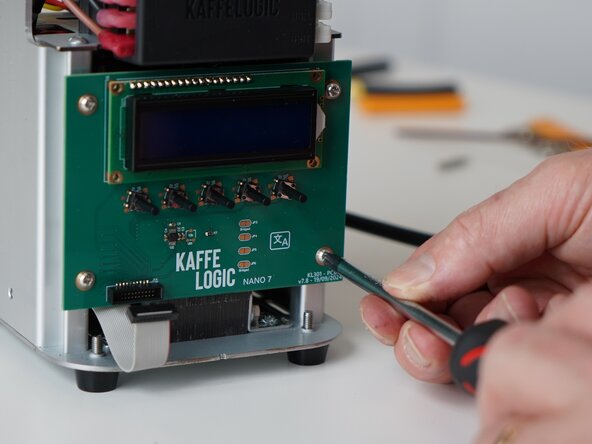

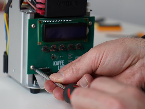

  7. Kaffelogic Nano 7/LINK (D-P Serial) LCD Board Replacement, Remove PCB screws: adım 7, 3 resimden 1. Kaffelogic Nano 7/LINK (D-P Serial) LCD Board Replacement, Remove PCB screws: adım 7, 3 resimden 2. Kaffelogic Nano 7/LINK (D-P Serial) LCD Board Replacement, Remove PCB screws: adım 7, 3 resimden 3.
    • Unscrew the 4x PH2 PCB screws.
    • These screws are captive to the PCB.

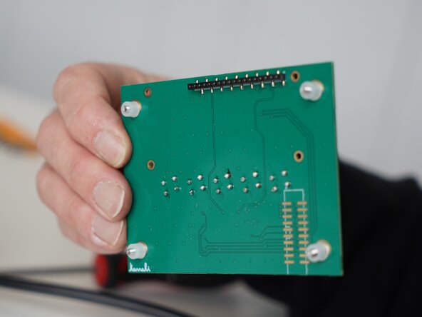

  8. Kaffelogic Nano 7/LINK (D-P Serial) LCD Board Replacement, Remove PCB: adım 8, 3 resimden 1. Kaffelogic Nano 7/LINK (D-P Serial) LCD Board Replacement, Remove PCB: adım 8, 3 resimden 2. Kaffelogic Nano 7/LINK (D-P Serial) LCD Board Replacement, Remove PCB: adım 8, 3 resimden 3.
    • Carefully remove the display PCB.
    • You may replace the ribbon cable while you have the panels off.
