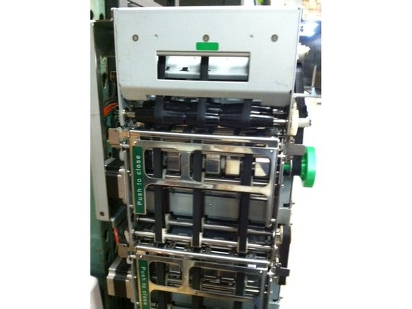

  4. M3t Kiosk  Preventative maintenance, Dispenser Belts: adım 4, 2 resimden 1. M3t Kiosk  Preventative maintenance, Dispenser Belts: adım 4, 2 resimden 2.
    • Clean belts on top and on the back of the dispenser.

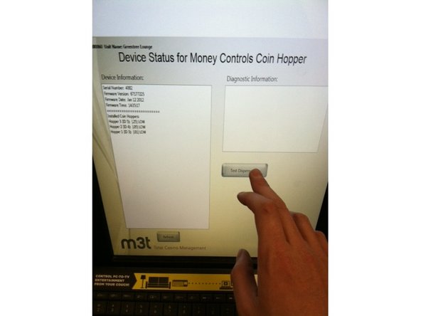

  5. M3t Kiosk  Preventative maintenance, Test Dispense: adım 5, 3 resimden 1. M3t Kiosk  Preventative maintenance, Test Dispense: adım 5, 3 resimden 2. M3t Kiosk  Preventative maintenance, Test Dispense: adım 5, 3 resimden 3.
    • Test dispense the coin hoppers and the cash dispenser

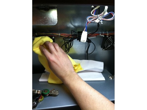

  14. M3t Kiosk  Preventative maintenance, Screen cleaning: adım 14, 1 resimden 1.
    • Clean the touch screen
