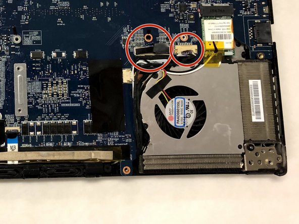

  5. MSI GS60 6QE GHOST PRO 4K LCD Screen Replacement: adım 5, 2 resimden 1. MSI GS60 6QE GHOST PRO 4K LCD Screen Replacement: adım 5, 2 resimden 2.
    • Lay the components out as shown.
    • The rightmost of the two cable connections is located under sticky tape. Remove the tape to access it and unseat from the connection.
    • The other connection is removed by gently pulling up on the black grip tape.

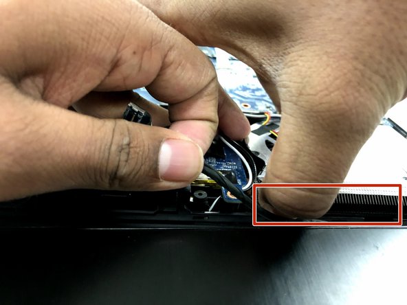

  9. MSI GS60 6QE GHOST PRO 4K LCD Screen Replacement: adım 9, 1 resimden 1.
    • Locate the metal bracket the cable is woven through.
    • Unweave the cable from the bracket. This will give you extra length to work with the screen.
