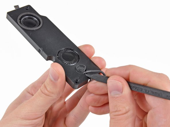

  26. MacBook Pro 17" Unibody Microphone Replacement, Microphone: adım 26, 2 resimden 1. MacBook Pro 17" Unibody Microphone Replacement, Microphone: adım 26, 2 resimden 2.
    • De-route the microphone cable from the channel molded into the left speaker enclosure.
    • Use the tip of a spudger to lift the microphone out of the left speaker enclosure.
    • Microphone remains.
