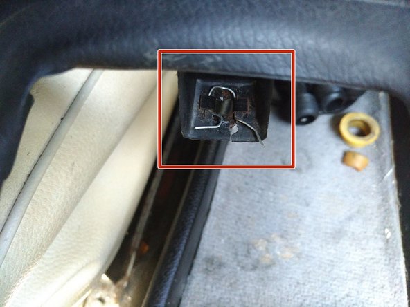

  4. Mercedes-Benz 114 or 115 Auto shifter bushings, Pull up on single clip at rear of centre-console trim: adım 4, 3 resimden 1. Mercedes-Benz 114 or 115 Auto shifter bushings, Pull up on single clip at rear of centre-console trim: adım 4, 3 resimden 2. Mercedes-Benz 114 or 115 Auto shifter bushings, Pull up on single clip at rear of centre-console trim: adım 4, 3 resimden 3.
    • The hardest, or second-hardest step
    • There is a simple metal trim clip holding the rear of the centre-console trim panel down (marked by a yellow box in photo 2)
    • You won't be able to see it easily, you can pry back the rubber trim in the marked area to gain a view of the clip (blue box area in photo)
    • In my car the plastic foot with the metal clip attached to it is cracked, so I added a small bit of wire to help pull it out next time so as not to break it (see red box in 3rd photo)

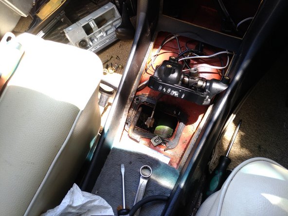

  7. Mercedes-Benz 114 or 115 Auto shifter bushings, Remove 3 bolts holding down the shifter surround: adım 7, 3 resimden 1. Mercedes-Benz 114 or 115 Auto shifter bushings, Remove 3 bolts holding down the shifter surround: adım 7, 3 resimden 2. Mercedes-Benz 114 or 115 Auto shifter bushings, Remove 3 bolts holding down the shifter surround: adım 7, 3 resimden 3.
    • You'll need a 10mm socket - I used a 1/4in deep
    • There are 3 bolts, one on the right-side and 2 on the left
    • They have a small wavy washer, don't drop it down the centre-console when you pull them out
    • You won't be able to remove the surround fully until the next step

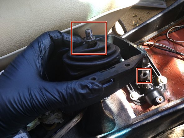

  8. Mercedes-Benz 114 or 115 Auto shifter bushings, Unscrew the shift lever and knob: adım 8, 3 resimden 1. Mercedes-Benz 114 or 115 Auto shifter bushings, Unscrew the shift lever and knob: adım 8, 3 resimden 2. Mercedes-Benz 114 or 115 Auto shifter bushings, Unscrew the shift lever and knob: adım 8, 3 resimden 3.
    • First loosen the 15mm jam nut (outlined in red)
    • Now you can unscrew the shift lever/knob
    • When you're re-installing it ensure it's clocked correctly before tightening the jam nut
  9. Mercedes-Benz 114 or 115 Auto shifter bushings, Remove shift linkage housing bolts: adım 9, 3 resimden 1. Mercedes-Benz 114 or 115 Auto shifter bushings, Remove shift linkage housing bolts: adım 9, 3 resimden 2. Mercedes-Benz 114 or 115 Auto shifter bushings, Remove shift linkage housing bolts: adım 9, 3 resimden 3.
    • There are four 10mm bolts, the left two bolts are hard to see, you'll need to pry the trim back a bit
    • The top-left bolt has the ground cable for the shifter backlight on it
    • The bolts have large flat washers on them, be careful not to drop them down the side of the console - use a magnet if necessary

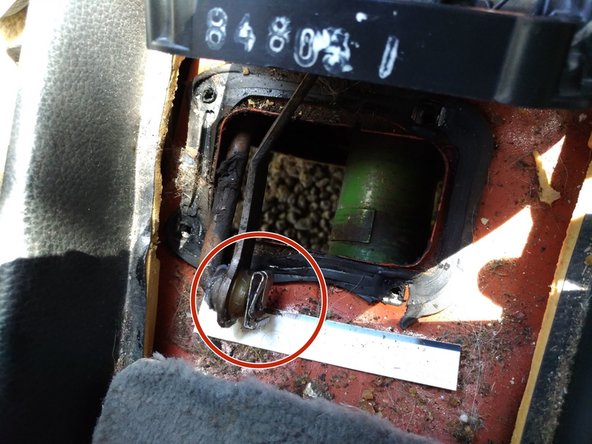

  10. Mercedes-Benz 114 or 115 Auto shifter bushings, Disconnect the shift rod: adım 10, 3 resimden 1. Mercedes-Benz 114 or 115 Auto shifter bushings, Disconnect the shift rod: adım 10, 3 resimden 2. Mercedes-Benz 114 or 115 Auto shifter bushings, Disconnect the shift rod: adım 10, 3 resimden 3.
    • After lifting up the shifter housing (black plastic part) you'll see it's attached to the shift rod below
    • The green thing in the picture is the driveshaft
    • To get better access, you can pull the shift rod towards the rear of the car (go through a few gears) as I did
    • The clip is fairly easy to remove with needle nose pliers and/or a small flat-head screwdriver
    • Be careful not to drop the clip down the side of the centre console or through the hole in the tunnel now revealed
    • These photos are actually from re-assembly, as you can see I lubed up all bushings with 3M Silicone paste - you could use any plastic-safe lube

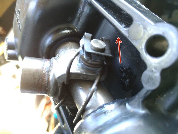

  12. Mercedes-Benz 114 or 115 Auto shifter bushings, Remove shift lever yoke - part 1: adım 12, 3 resimden 1. Mercedes-Benz 114 or 115 Auto shifter bushings, Remove shift lever yoke - part 1: adım 12, 3 resimden 2. Mercedes-Benz 114 or 115 Auto shifter bushings, Remove shift lever yoke - part 1: adım 12, 3 resimden 3.
    • Remove a clip from one end of the small rod connecting the shift lever yoke to the main rod
    • Again as these photos were taken during re-assembly there is silicone lube present

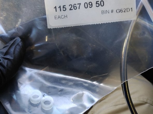

    • You can see there is a tiny bushing in between the spring and the small rod on each end - these bushing are optional but cheap, mine were completely gone
    • The small bushing part number is: 1152670950
    • I used a small screwdriver and needle-nose pliers to remove the clip (slide in direction of red arrow)

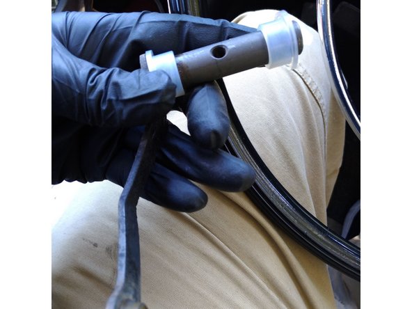

  13. Mercedes-Benz 114 or 115 Auto shifter bushings, Remove shift lever yoke - part 2: adım 13, 3 resimden 1. Mercedes-Benz 114 or 115 Auto shifter bushings, Remove shift lever yoke - part 2: adım 13, 3 resimden 2. Mercedes-Benz 114 or 115 Auto shifter bushings, Remove shift lever yoke - part 2: adım 13, 3 resimden 3.
    • Some better views of those tiny bushings as you pull the small rod out (slide rod out in direction of arrow)
    • These photos were during re-assembly so the bushing is fresh and clear, the old ones would probably be yellowed or cracked or missing
    • I put a blue circle on one end of the small rod and a red circle on the other end so you can identify them better
    • I used again the small screwdriver and needle-nose pliers to pry the spring back while re-inserting the bushings

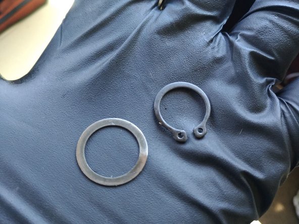

  15. Mercedes-Benz 114 or 115 Auto shifter bushings, The snap ring: adım 15, 3 resimden 1. Mercedes-Benz 114 or 115 Auto shifter bushings, The snap ring: adım 15, 3 resimden 2. Mercedes-Benz 114 or 115 Auto shifter bushings, The snap ring: adım 15, 3 resimden 3.
    • Now the hardest or second-hardest step
    • Removing the snap-ring
    • If you have small snap-ring pliers this is probably pretty easy
    • If not you might be lucky like I was and the needle-nose tips fit into the holes
    • Even so it was a challenge to install and remove the snap-ring
    • Also the part will probably go flying, so do the disassembly in a place where you can find it if it goes flying
    • The washer goes under the snap ring
    • As you can see these photos are from re-assembly, my old bushing was yellowed and the left-side in pieces
