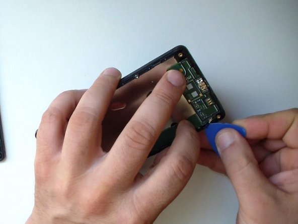

      • The board is glued to the main frame by adhesive tape.
      • Use a hot gun or hair dryer and warm the board.
      • Now you can easy separate the board from the main frame.
      • For the separation process use only plastic tools.
